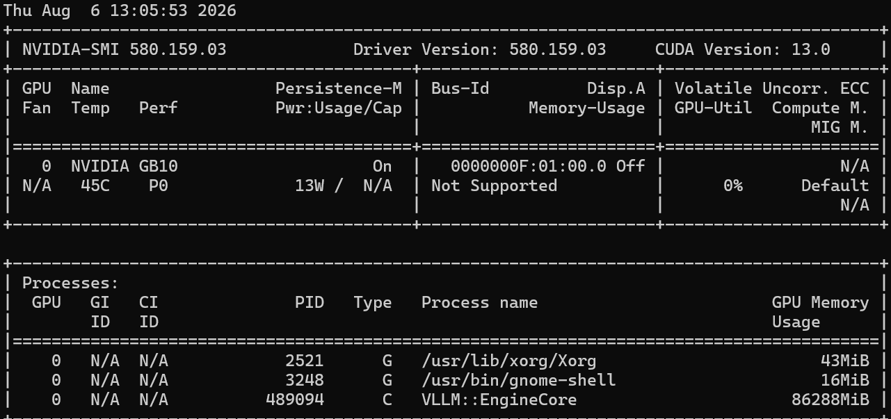

Have you considered the energy costs? The DGX Spark requires a 240W external power supply. Assuming 120W actual consumption = ~1,000kWh/yr. If you live in San Diego, that’s ~$750/yr! (Seattle ~$200/yr, EU €290/yr)
NOT an issue at all. It idles at 15w and sips juice. Its VERY efficient. San Antonio pays approx 7c/kWh… I have the breakdown I did on inference cost in Friday’s Party if you’re interested - wround post 610-620 I think.
Modern machines dont run flat out all the time - gone is the day of the 800w PS drinking power all the time.
I assume you mean 15Watts
Yep I was in mid edit. It also draws lower but 15 is a good idle assumption. WAY better than any other server / workstation class hardware I’ve ever used.
and I just grabbed a snap:
That box is runninng my always on summary pipe right now and can be tapped for opencode, claw, Hermes, other variants of agent.
Also note - thats nvidia/Gemma-4-26B-A4B-NVFP4 loaded currently, it’s my Hermes-Opencode capable but not too much for HA model.
