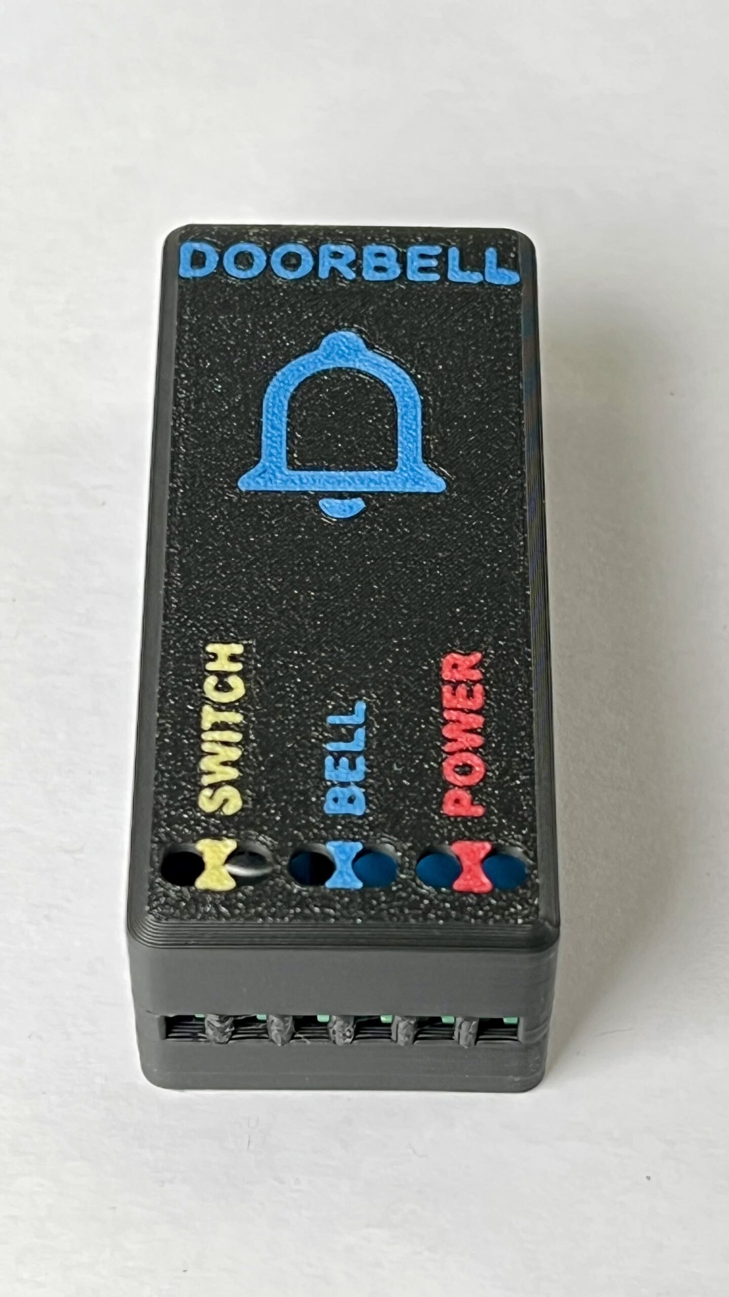

I found a solution that seems simple: The prebuilt one by Marcel Zuidwijk that I can just plug into my doorbell. But that one confuses me too and it seems like its creator is rather unresponsive, so I’d like to ask about it here:
  1. I have two wires coming out of my wall connected to my doorbell.
    Do I stick those into where it says “POWER” on the case of Marcel’s doorbell?
  2. Can I put any of the two wires into any of the two POWER-slots?
  3. Do I then need two additional wires that I connect from where it says “BELL” to my doorbell?
  4. What do I plug into “SWITCH”? The button that is used to open the doorbell or the one used to trigger the chime?

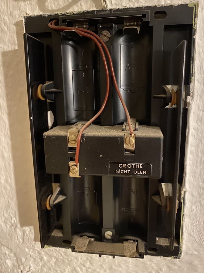

  2. Can I remove the chime without breaking anything? The only part that looks potentially removable is this pin but I don’t wanna risk pulling it out and breaking the thing.
I use the doorbell module from Marcel Zuidwijk and it works fine.
I have a classic doorbell setup like yours with a transformer, a pushbutton and a doorbell.
the wires going to the doorbell and from the button, should arrive where the transformer is and this is the place where you have to install the Zuidwijk module.
this way you don’t have to rewire anything.
you only have to connect the existing wires to the correct connectors of the doorbell module.
2 wires from the transformer (low voltage side) to the power input
2 wires from the button to the switch connector
2 wires from the doorbell to the bell connector
I only have two wires coming out of the wall though and not four. And I don’t even know what the cables are from. So what now?
The wires in your photo are the wires of the bell, these are not the ones you need.
There should be a transformer somewhere, usually situated in the main fuse box.
