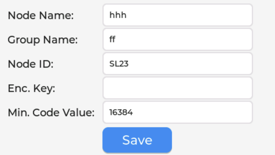

I have the following LVGL "form":
Basically, a "form" container with nested containers consisting of (label, textarea).
Each textarea is tied to a restorable global; in other words, preferences that I want to save and restore.
My question: how can I implement saving these preferences in the most flexible way?
I can use on_ready on each textarea so when it is changed I update the preference from there directly. However, I'd rather queue up changes and save them only when the "Save" button is pressed (also because some preference changes require a reboot and I don't want to reboot for each individual change).
I'd also rather not depend on a hardcoded the list of textarea id's in an on_press on the Save button.
So right now, I'm using the following method: the Save button on_press calls a lambda that finds all textareas in the form container, then sets their state to LV_STATE_USER_1, and each textarea uses an on_state_change handler to check if this state gets set. If so, it will save the preference and set another global to signal if a reboot is required.
It works, and it's flexible, but a bit convoluted.
Ideally, I want to emit an event (or set a state/flag) on the "form" container that gets passed down all of its children, and listen for it on each textarea in an on_... handler, but I haven't found a way of doing so.
Any ideas?
