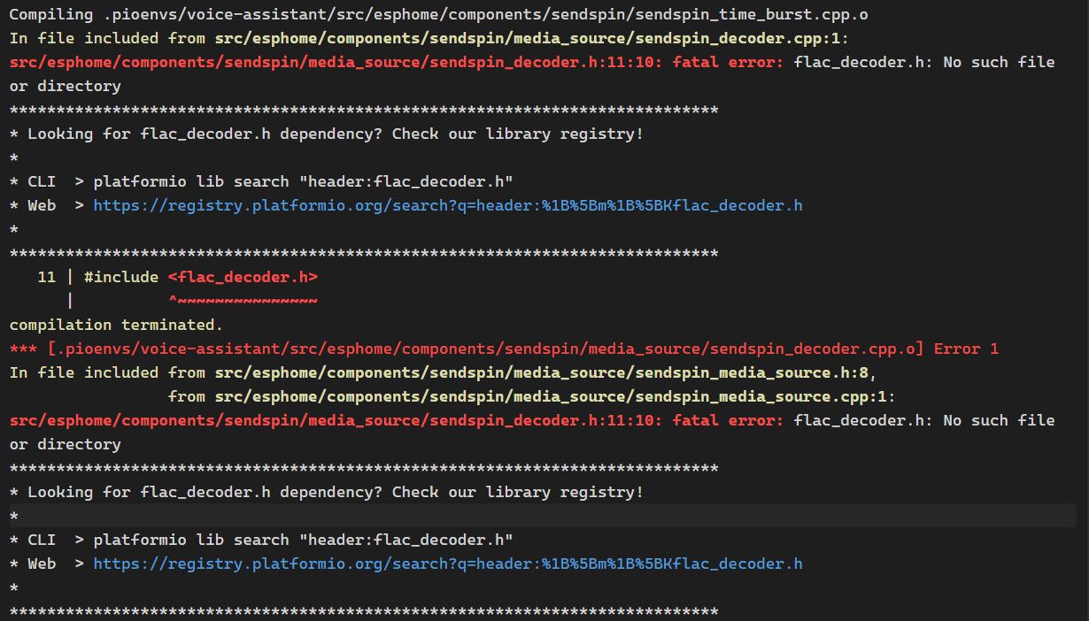

I am trying to compile the YAML listed at https://github.com/user-attachments/files/27310578/home-assistant-voice.yaml with ESPHome ver 2026.5.3, but I get this error:
   11 | #include <flac_decoder.h>
compilation terminated.
*** [.pioenvs/voice-assistant/src/esphome/components/sendspin/media_source/sendspin_decoder.cpp.o] Error 1
In file included from src/esphome/components/sendspin/media_source/sendspin_media_source.h:8,
                 from src/esphome/components/sendspin/media_source/sendspin_media_source.cpp:1:
src/esphome/components/sendspin/media_source/sendspin_decoder.h:11:10: fatal error: flac_decoder.h: No such file or directory
* Looking for flac_decoder.h dependency? Check our library registry!
* CLI  > platformio lib search "header:flac_decoder.h"
* Web  > https://registry.platformio.org/search?q=header:%1B%5Bm%1B%5BKflac_decoder.h
Could someone suggest what I need to do to fix this error, please?

When I try to compile this code in ESPHome version 2026.6.2, I get a "Compilation Failed" message with the following information (I have posted a screen-shot in order to retain the colours and layout of the original error message):
Which is fine, except that I have no idea how to fix that error.
I have cleaned the build files and reset the build environment, but the error still occurs.
I have also tried some YAML changes as suggested by Google's Gemini, but that hasn't helped either.
I am at a complete loss, so any suggestions will be welcomed ...
