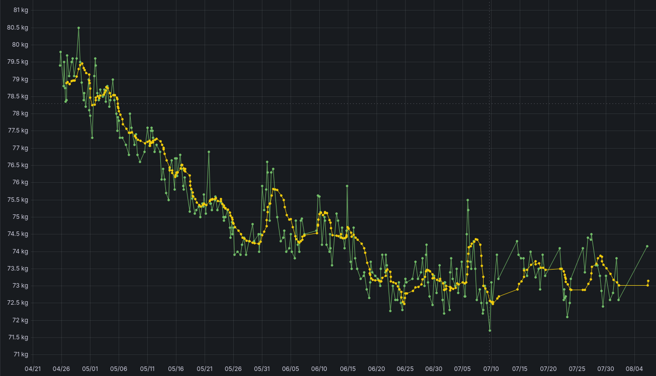

I am monitoring the results with Grafana and it has certainly helped motivate me to lose weight. This is the data since I started using it (also sharing this 'cause I am a little proud of myself :sweat_smile:):
Green: Raw weight values
Yellow: Moving average with window size 10
