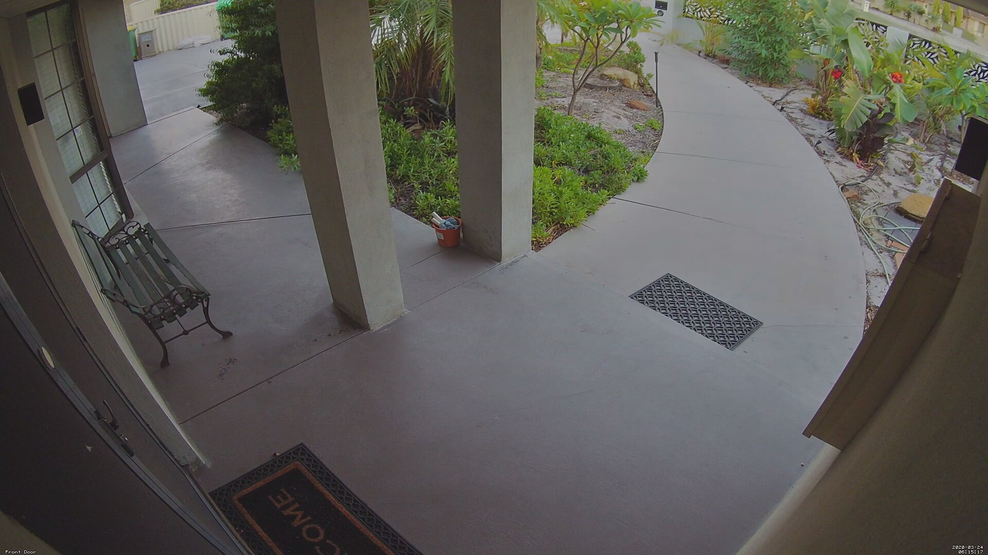

Video quality is excellent you can go on youtube and look at demos. Also a good way to look at the lens options which will determine your zoom vs FOV.
I can’t speak to audio, I am only doing video in my setup. Nor do I do PTZ, just static bullet cameras setup to capture the FOV I am interested in. One downside of the Hikvisions I have to admit are the build in cables. Kind of sucks to install them, but again it was another tradeoff. I ended up using Amcrest junction boxes to accommodate the cable harness. I wish they would’ve just had RJ45 female ports. Also be aware these are just CAT5, they only push 10Mbps so there is no need to run CAT6, etc.

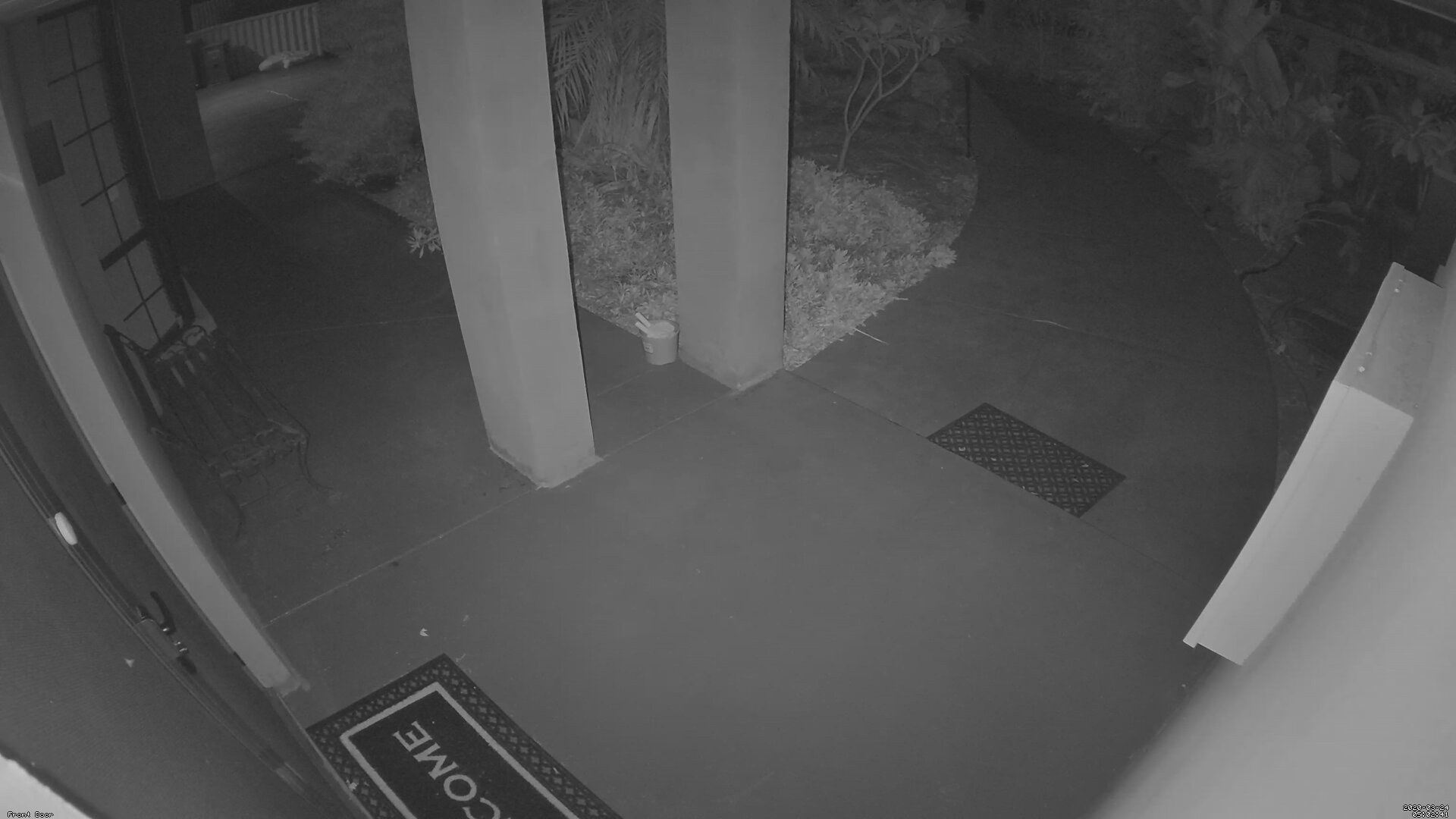

First off don’t buy no name camera’s off of Alibaba, make sure you buy a reputable brand from a reputable seller, your only asking for issues and may stuck with a camera that doesn’t allow firmware upgrades. I also dont recommend using traditional NVR, personally I run Blue Iris which is one of the best software NVRs IMHO. It offers way more flexibility than a hardware based NVR, and much wider compatibility compared to a manufacturers hardware based NVR. Also don’t chase Megapixels especially if low light performance is important to you. Generally higher Megapixels means the pixel’s are smaller and can’t take in as much light. I highly recommend you read the IP Cam Talk Wiki - https://ipcamtalk.com/wiki/ip-cam-talk-cliff-notes/

Yeah, I switched from Unifi to the Hikvisions, they can’t really compete. They only have 1080p which is 2MP, my 8MP cameras are 4x the resolution for less than the price they are asking for. People on their forum are constantly hoping the next camera will be better, but for some reason they seem to be stuck in 8 years in the past on camera technology. I use their switches though, I am a network engineer and those are very competitive and full featured.
