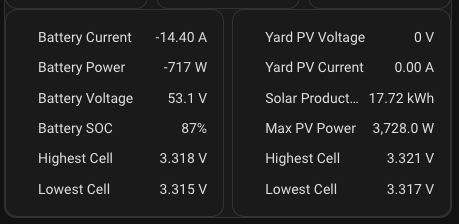

Looks like latest update broke card_mod and removal off the icons on my entities
Before the update, the icons were removed from this entity list.

What is the best way to remove these icons now and the space they take up?

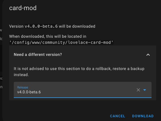

Try the card-mod beta version. It has many fixes (and breaking changes).
What do you mean? Update of what ? HA?
Home Assistant update to entities card to fix spacing of conditional rows has mean that card-mod patching method needs to be updated. Card-mod v4 beta has a fix for this.
Yes, Home Assistant core
How can I update to card-mod 4?
I see Card Mod 3
if you are using HACS you can select Redownload and select the latest beta under ‘Need a different version?’ Make sure to read the release notes carefully as there is a breaking change that may mean you need to adapt your styling.
ok, I see the beta now. Guess I should get the latest beta…
Yes, latest beta is v4.0.0-beta.6
Thanks Darryn, downloading that beta fixed them.
You can remove the following section from your code:
margin-left:0 !important;
It’s not really needed and without unit, it’s doing nothing.
