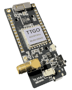

ESPHome has a proven track record and a superior protocol (native api) then mqtt :trophy:
It supports a good amount of transceivers with lora modulation :point_down:

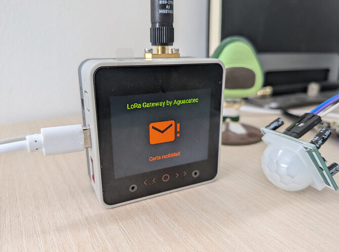

A few years ago I did a LoRa mailbox (motion) sensor and used OpenMQTT Gateway on the home side to talk to HA. At that time, I don’t believe ESPHome had any LoRa solutions, but as the others above have posted, now there are. I came across the following which seems to provide a nice guide for both the remote node and the gateway using ESPHome.
