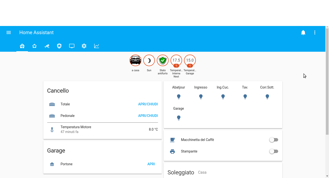

i can’t solve this vertical stack configuration problem…
i my first view i wold like to have 3 columns, below the configuration…i only see 2 columns, why?
views:
- title: Dashboard
icon: mdi:home-assistant
badges:
- sensor.davide_tasker_track
- sun.sun
- sensor.stato_antifurto
- sensor.entryway_thermostat_temperature
- sensor.temp_garage
cards:
- type: vertical-stack
title: Comandi
show_header_toggle: false
cards:
- type: entities
title: Cancello
entities:
- type: call-service
icon: mdi:gate
action_name: Apri/Chiudi
service: switch.toggle
service_data:
entity_id: switch.apertura_cancello
icon: mdi:gate
service_data:
entity_id: switch.apertura_ped_cancello
- type: divider
- entity: sensor.temp_est_cancello
secondary_info: last-changed
- type: conditional
conditions:
- entity: switch.apertura_garage
state: "on"
card:
type: entities
title: Garage
entities:
icon: mdi:garage
action_name: Chiudi
service_data:
entity_id: switch.apertura_garage
conditions:
state: "off"
card:
type: entities
title: Garage
entities:
icon: mdi:garage
action_name: Apri
service_data:
cards:
- type: glance
show_state: false
entities:
- entity: light.abatjour_camera_letto
tap_action:
action: toggle
hold_action:
action: more-info
- entity: light.yeelight_rgb_7c49eb12ca52
tap_action:
action: toggle
hold_action:
action: more-info
- entity: light.ingresso_cucina
tap_action:
action: toggle
hold_action:
action: more-info
- entity: light.tavernetta_2
tap_action:
action: toggle
hold_action:
action: more-info
- entity: light.corridoio_sotto_2
tap_action:
action: toggle
hold_action:
action: more-info
- entity: light.garage
tap_action:
action: toggle
hold_action:
action: more-info
- type: entities
entities:
- entity: switch.07202524dc4f223a44a9
name: Macchinetta del Caffè
icon: mdi:coffee
- entity: switch.07202524dc4f223a9793
icon: mdi:printer
cards:
- type: weather-forecast
entity: weather.casa
If I recall, the wrap to the next column won’t take place until you have more than 4 items listed.
