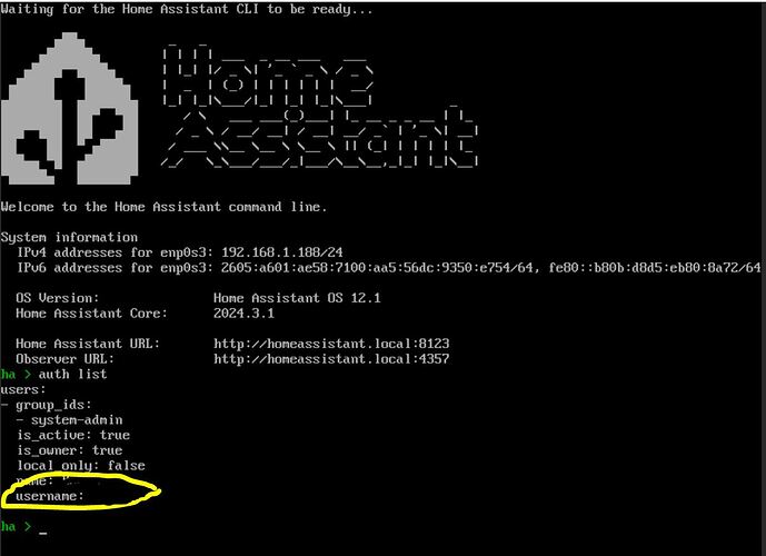

This was much easier following the written FAQ than reading this thread. Here is all I had to do: type ā€œauth listā€ on the terminal CLI.
