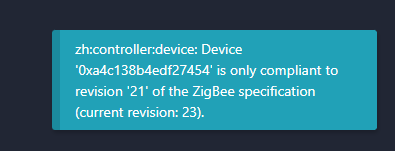

Hello, I am new to HA and Zigbee. I painstakingly configured a smart knob to work as i needed but with a new update, i lost some functionality on this knob. When i try to interview this device, i get this pop-up. is there a way to get all the functionality back?

This refers to the used device following a zigbee protocol standard before zigbee 3.0.

It is a warning, not an error
