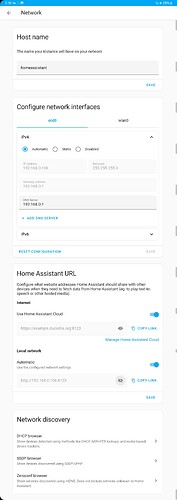

I have fix this problem by restarting HA after my router reconfiguration (IP address of HA has changed). Then correct HA Local network URL has shown in the HA network configuration.
