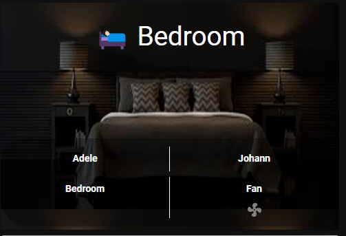

Lovelace: Banner card
Still not clear how to make the banner heading text smaller???
Where does style: go?
Thx
type: custom:banner-card
heading:
  - mdi:bed
  - Bedroom
background: green
entities:
  - entity: group.bedroom
  - entity: sensor.bedroom_temp_zigbee
  - entity: light.bedroom_lamp_1
    name: Bedroom Lamp 1
Hi Amanda,
For me it works like this:
card_mod:
  style: |
    ha-card .heading {
      font-size: 1.75em;
      font-weight: 400
