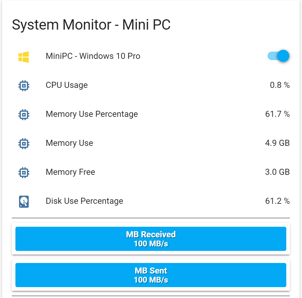

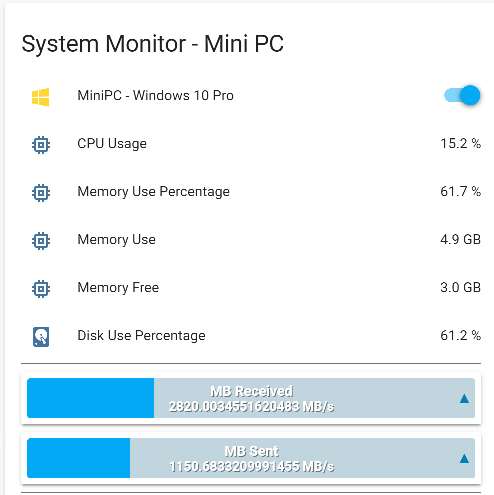

if i’m not using max option it wont display the full number just maxed of 100MB,
any one know what do ?
with max option enabled:
without max:
The max value clamps to the max value set so you don’t see the decimals, otherwise it should just show the state value from your entity. I suspect you entity value actually has the decimals in it.

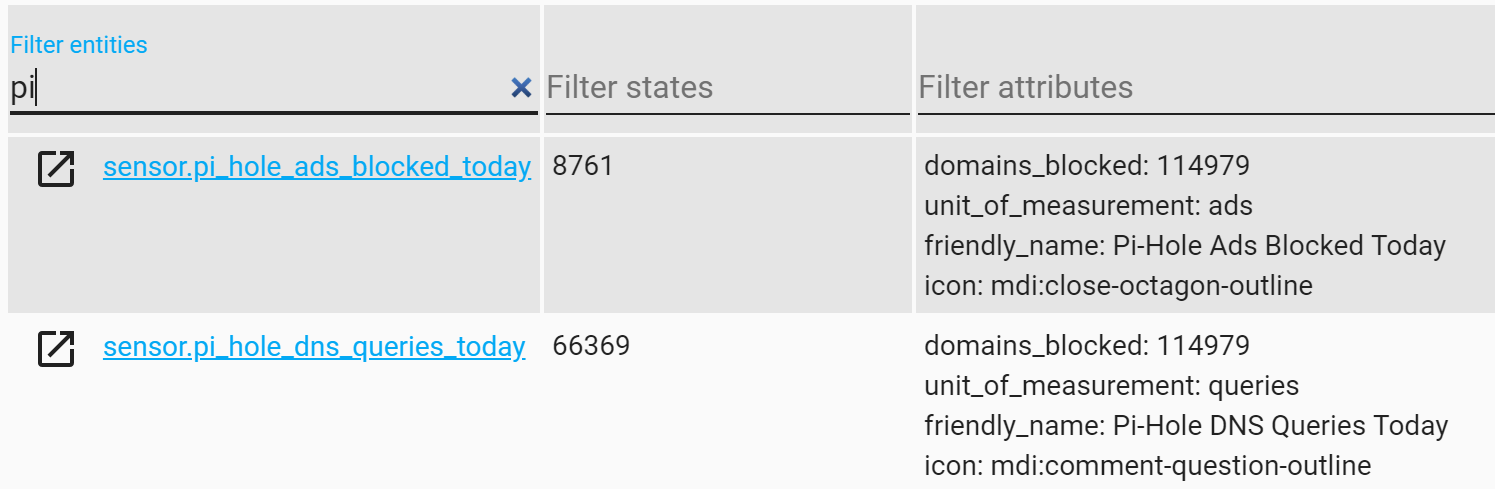

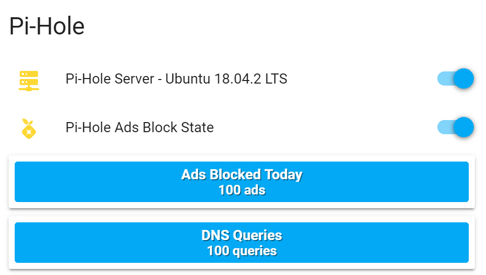

i have the same behavior with pi-hole display ads number, if not enabling the max option it will display 100 ads.
config :
- type: custom:bar-card
title: Ads Blocked Today
title_position: inside
entity: sensor.pi_hole_ads_blocked_today
max: 10000
title: DNS Queries
entity: sensor.pi_hole_dns_queries_today
max: 100000

This looks like a bug if it’s adding decimals that are not in your entity state, I’ll have a look and see if I can reproduce it.

Sorry for the late response. I haven’t been able to track down the bug, however I did add an option in 1.5.0 to limit the amount of decimals displayed on the card. Hope this is sufficient to fix the issue you are having.
