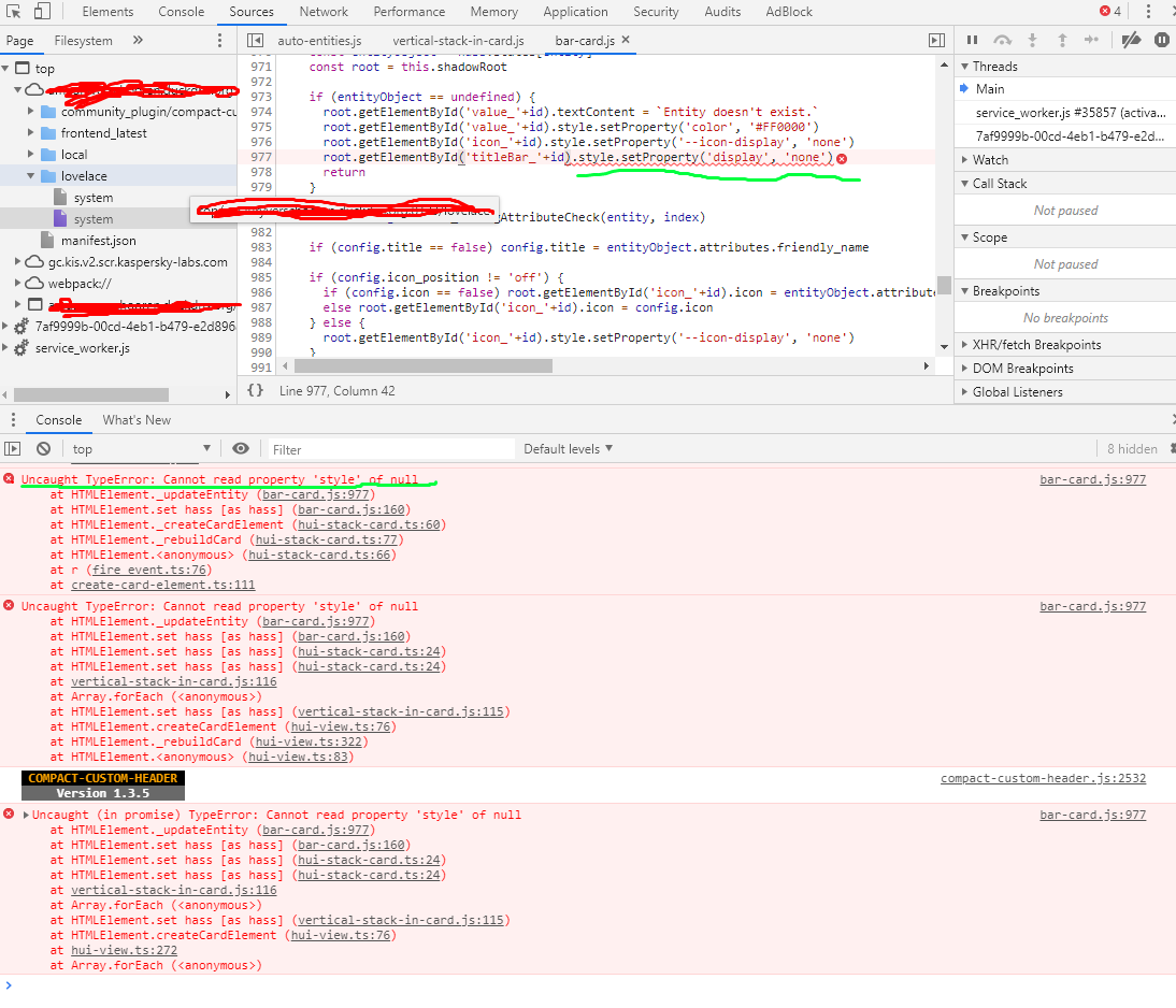

The max value defaults to 100, so you’ll still have to set your max value.
Could you share your config for this bar? I don’t know what’s going on from the image you’ve posted.
you mean the bar-card yaml file or? the resource link?
The yaml code from your lovelace config.
that’s from my system tab. my lovelace config is split in multiple yaml files.

I think I know what’s causing this, your config is fine. I’ll see if I can fix this tonight or tomorrow, should be an easy fix.
Should be fixed in 1.5.1.
didn’t fix the problem for me
@Gluwc

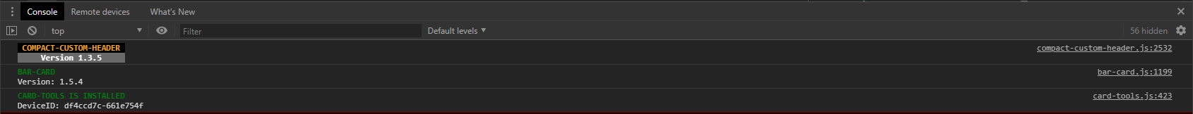

Should be fixed in 1.5.4.
If it’s still not working please check your console log to make sure you’re running the latest version.
