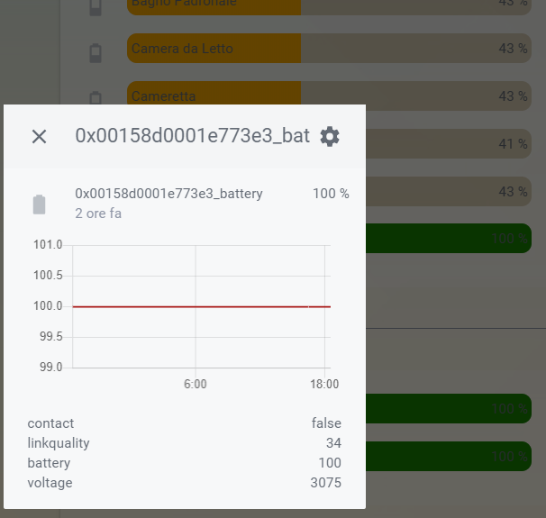

Now I have the problem that for all bars with value Low or High the color is the “darker” color of the bar, not the “bright” one. See the green color in this screenshot:
How can I fix this so that always the bright color is used?
Thanks!
This seems like a bug, when the value is a string it should show a full bar. I’ll try to fix it in the next release.
