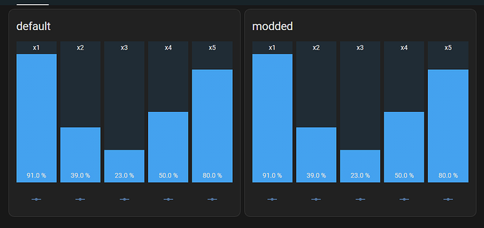

RTL + vertical bars:
Card:
  - <<: &ref_card
      type: custom:bar-card
      entities:
        - entity: input_number.test_level_1
        - entity: input_number.test_level_2
        - entity: input_number.test_level_3
        - entity: input_number.test_level_4
        - entity: input_number.test_level_5
      height: 300px
      stack: horizontal
      direction: up
    title: default
Displayed in English:
Displayed in RTL:
How to fix:
  - <<: *ref_card
    title: modded
    card_mod:
      style: |
        :dir(rtl) bar-card-card:not(:last-child) {
          margin-right: 0px;
          margin-left: 8px;
Result in English - untouched:
Result in RTL - FIXED:
Thanks man its working!!

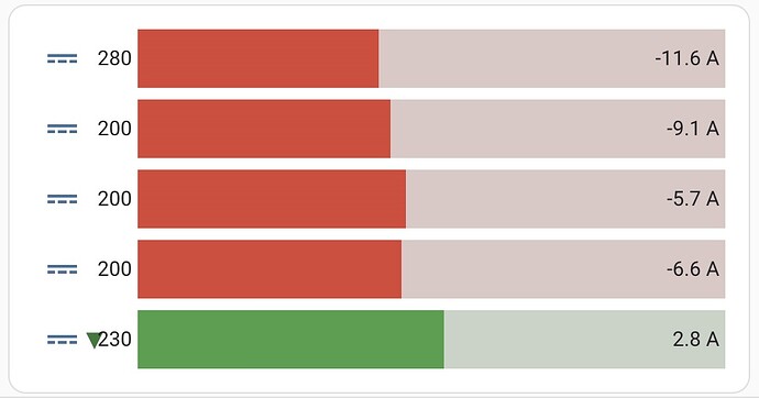

The only solution I found was to make two cards with the left one flipped. Is it possible to go further and put both groups of bars in one card without borders around those groups. Now I have #1 picture and want picture #2. Code is attached. Thank you!
      - type: horizontal-stack
        cards:
          - type: custom:bar-card
            entities:
              - entity: sensor.deye_sunsynk_sol_ark_current
              - entity: sensor.deye_sunsynk_sol_ark_current_2
              - entity: sensor.deye_sunsynk_sol_ark_current_3
              - entity: sensor.not_connected_current
              - entity: sensor.deye_sunsynk_sol_ark_x_2_battery_5_current
            icon: mdi:current-dc
            min: 0
            max: -65
            height: 25px
            title: "->"
            direction: right
            positions:
              indicator: "off"
              value: "off"
              icon: "off"
            severity:
              - color: "#db4437"
                from: -65
                to: 0
            card_mod:
              style: |
                ha-card {
                  transform: scaleX(-1);
                  box-shadow: none;
                  margin: 0px;
                  padding: 0px;
                bar-card-currentbar, bar-card-backgroundbar {
                  border-radius: 8px;
                  border: 0px solid;
            entities:
            min: 0
            max: 65
            height: 25px
            title: "->"
            positions:
              indicator: "off"
              icon: "off"
              value: inside
            severity:
              - color: "#43a047"
                from: 0
                to: 65
            card_mod:
              style: |-
                ha-card {
                  box-shadow: none;
                  margin: 0px;
                  padding: 0px;
                  border-radius: 8px;
                  border: 0px solid;
