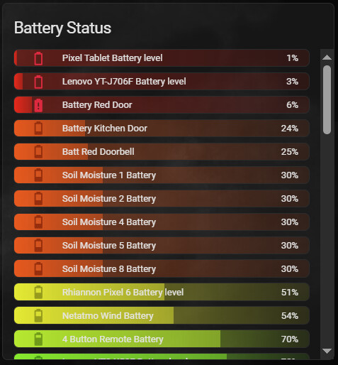

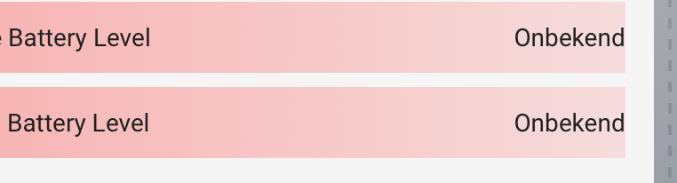

I did have the scroll working on the card today. As you can see in the screen shots. The errors don’t always show immediately. I am interested if they will start to show?

I think I may have cracked it finally… well nearly.
CHANGES
  • Labelled all of my battery entities I want the card to use including unknown and unavailable sensors. (indicating they are completely out of battery)
  • Added a raw state check to check for unavailable or unknown and convert those values to zero.
                - label: battery
                  options:
                    card_mod:
                      style: |
                        hui-generic-entity-row {
                          background:
                            {% set raw_state = states(config.entity) %}
                            {% if raw_state not in ['unknown', 'unavailable'] %}
                              {% set perc = raw_state | float %}
                            {% else %}
                              {% set perc = 0 %}
                            {% endif %}
                            {% set rest = 100 - perc %}
FULL CARD CODE

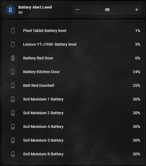

Other auto entities card, that uses an input number to change the content of the card
         - type: custom:mushroom-number-card
            entity: input_number.battery_alert_level
            layout: horizontal
            display_mode: buttons
          - type: custom:auto-entities
            filter:
              template: |
                {% for entity in states %}
                  {% if entity.attributes.device_class == 'battery'
                        and entity.attributes.unit_of_measurement == '%'
                        and entity.state not in ['unknown', 'unavailable'] %}
                    {% set battery_level = entity.state | float %}
                    {% set threshold = states('input_number.battery_alert_level') | float %}
                    {% if battery_level <= threshold %}
                      {{ entity.entity_id }},
                    {% endif %}
                  {% endif %}
                {% endfor %}
            options: null
            show_empty: false
            card:
              type: entities
            sort:
              method: state
              numeric: true
Couldn’t tell.

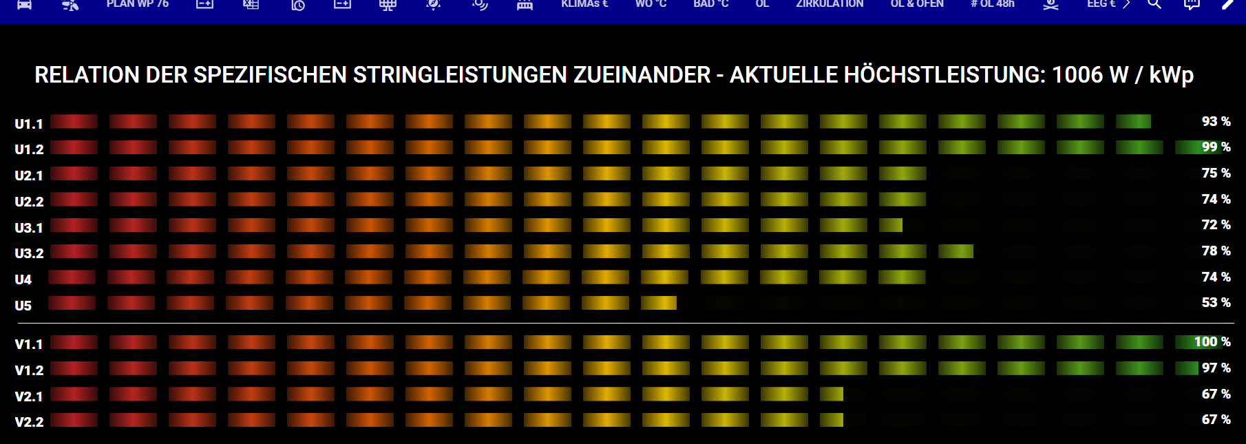

Hi Mike,
great support and explanation how to improve the card .
But weird things have happened meanwhile or should I say the weird things before have been reversed:
For whatever reason the card_mod: lines are now still there if I want to edit the card - they are no longer being deleted.
I have no clue what had caused the issue.
I can also not say what has made this to happen unless it happened this morning while working with chatgpt on the topic of “dynamic title” for the bar which is showing the 100% value of the sensor - in this case the production of the best PV string on the roof.
It took quite a while cause first chatgpt suggestions did not work at all and code was not really homeassistant related. Just pure phantasy adding a sensor into the title: line.
I am using lmarena.ai where I get 2 answers from 2 models and in this case the 2nd answer was the best by explaining that a real dynamic title is not possible with a usual bar card but with a vertical stack of a markdown card for the headline or title and then the well known bar card.
Step by step chatgpt found a way to increased fontsize and thickness / bold . Also background and then remove the rounded corners.
But finally I was able to fix and understand more of your code and help myself cause I had removed the separator blank sensor at one point and the line had vanished when I did not realize it and had to search for it.

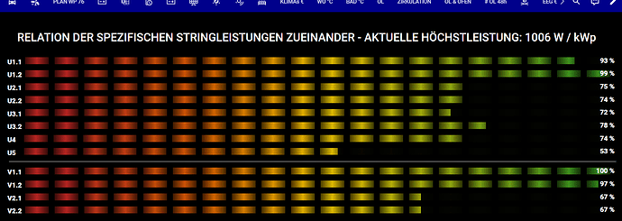

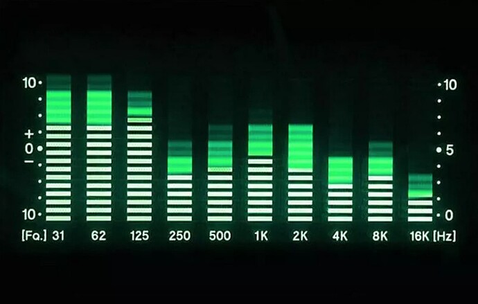

Here is the final resuult and I am happy with that, hence time to share the code for the 80s and 90s equalizer LED style bar I was looking for inspired by this:
and my card looks like this
with this code thanks to your constant support - really appreciated and I also learned a lot to play around and look into the lines you had provided or asked chatgpt what which parameter would mean.
THANKS A LOT

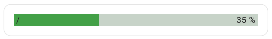

Hi all,
I see all these cool rounded bars, but I cannot get my bars to appear so nicely rounded anymore… I’m quite sure it was working initially with the below code, but now the bar is ugly square… Any suggestions what could be the cause?
- type: custom:bar-card
  card_mod:
    style: |
      bar-card-currentbar, bar-card-backgroundbar {

Hmm, weird. Turns out I had to change this:
  border-radius: 10px;
to this:
bar-card-background {
I’m almost certain it previously worked without the extra keys… But thanks for the tip in the right direction!
I doubt that this was the reason.
So did I, but I can reproduce it live. Here’s a video of it happening:
https://breedborst.duckstad.net/nextcloud/s/DbEsHkCYjENaTwa
Cannot check a video right now. Will try to simulate your case when will be near a Pc.
No worries. It’s working right now, so I’m happy regardless. :slight_smile:
I’ve noticed that as well, but since it does what I want it to do, I’m going to stick with the existing version, at least until such a point when a HA upgrade breaks it, then I’ll look at switching. :slight_smile:
