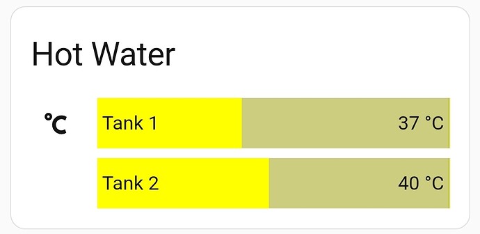

I have been using the original Bar-Card for both vertical and horizontal bars. All good until the depreciation warnings in HA.
So I came here looking for a solution, I then deleted the original hacs card and installed this fork mentioned above. Now all my bar colour has disappeared and no mater what I have tried, even starting a new card completly from the documentation example still cannot get the bar fill colour back. All the other config for the bar card forked version works, just not the colour
amy ideas?

Did you manage to fix the no color issue? It have similar problem, colors are very dark and difficult to see
Hi @Sk3wby
I was refering to the bar card, no I did not manage to get the fill colour in the maitained verdion. So i reverted back to the original so I still have the Logs warning but at least my bars are filling correctly:
Thanks for the feedback, i have reverted too! At least it works for now

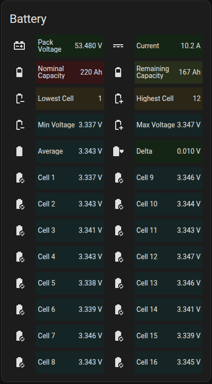

Heres my version based on the code above
 thought it might be useful to someone who is looking for something similar
          - type: custom:bar-card
            columns: 1
            decimal: 0
            min: 3000
            max: 40000
            positions:
              icon: "off"
              minmax: "off"
              indicator: "off"
            direction: right
            height: 28px
            entities:
              - entity: sensor.brewery_power_brewery_power_power_consumption
            card_mod:
              style: >
                ha-card {
                  background: transparent !important;
                  color: #FFFFFF;
                  --ha-card-header-color: white;
                  border-radius: 0px;
                bar-card-background bar-card-backgroundbar {
                  background: linear-gradient(
                    90deg,
                    #619B2A 0%,   /* LightBlue at min (0%) */
                    #54C23E 37%,  /* Lighter blue */
                    #31B543 50%,  /* Gold/yellow at mid-point */
                    #FF9021 75%,  /* Dark orange near top end */
                    #FF0000 100%  /* Firebrick red at max */
                  mask-image: repeating-linear-gradient(90deg, rgba(0, 0, 0, 1) 0.9%, black 1.5%, rgba(0, 0, 0, 0.01) 2%, black 2%, black 2%);
                  border-radius: 5px;
                  filter: brightness(0.95);
                  opacity: 0.15;  /* slightly increased visibility */
                bar-card-background bar-card-currentbar {
                    90deg,
                  clip-path: polygon(0 0, var(--bar-percent) 0, var(--bar-percent) 100%, 0 100%);
                  border-radius: 0px;
                bar-card-value {
                  margin: 20px;
                  font-size: 2rem;
                  font-weight: 800;
                  color: #FFFFFF;
                bar-card-name {
                  margin: 20px;
                  font-size: 1.25rem;
                  font-weight: 800;
                  color: #FFFFFF;
                #states > bar-card-row:nth-child(9) > bar-card-card >
                bar-card-background > bar-card-contentbar > bar-card-value {
                  display: none;
                bar-card-background > bar-card-contentbar > bar-card-name {
                  display: none;
                bar-card-iconbar {
                  display: none;
                bar-card-background {
                  background-color: white;
                  height: 1px !important;
                #states > bar-card-row:nth-child(9) {
                  margin-top: 1px;

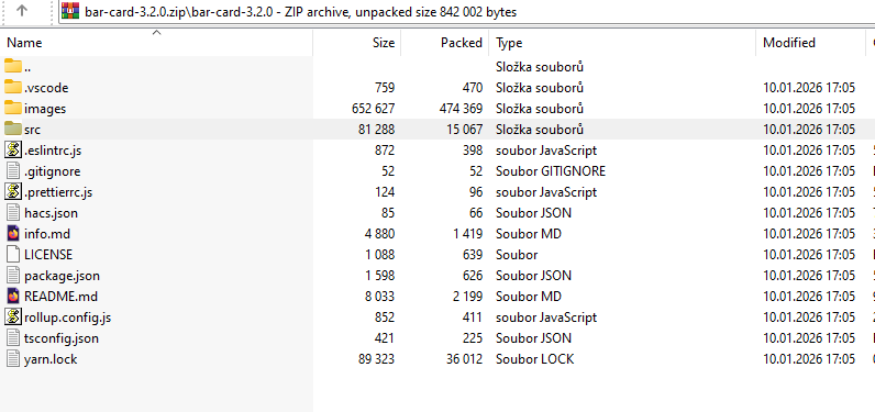

Hi, I wanted to install this card, but it has been removed from HACS. However, some forks still work. Is it possible to install the card “manually” somehow?
Thanks
Although the original card was removed from HACS, it still works fine. Try adding in HACS via “add custom repo” menu.
Unfortunately, that doesn’t work.
What “that” does not work?
This installation method
If you are interested to solve your problem, you should have been less laconic and describe what exactly you did, what exactly you got. Looks like I am forcing you to be helped.
☐ Adding the custom repo does not work
☐ Adding the custom repo works but installing the card does not work.
☐ I’m getting an error message but don’t want to post it here.
Sorry, i tried adding /hacsfiles/bar-card/bar-card.js using the UI, but the card does not appear after refreshing. I couldn’t find the ui-lovelace.yaml file in HA
to which I could add
resources:
  • url: /hacsfiles/bar-card/bar-card.js
    type: module
There are 2 ways of installing a custom card:
  1. Manual: download a corresponding JS file, place it in “www” folder, then open any dashboard, select “resources”, add a line “/local/xxxx.js”.
  2. Automatic with HACS - then HACS itself downloads the JS file, creates a corresponding “xxx” folder in a “www/community” (stands for “hacsfiles”), places the JS file into that folder, registers the new added resource. Means - you do not need to bother about it.
  1. I downloaded source code.zip from there github, but there is no file named bar-card.js.
  2. This repo does not offer automatic installation, and manually adding the source in the UI does not work.
