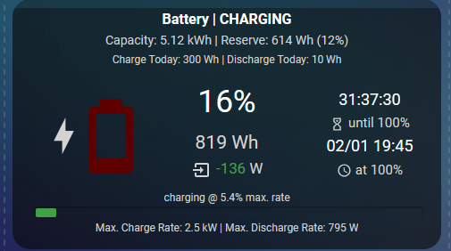

nice card, I just made some template variables to be able to use it with my Marstek Venus E V3 battery. But i’m wondering which values are expected for custom_battery_charge_rate and custom_battery_discharge_rate ? in what units are those? How can i calculate those with my existing current power & kWh counters ?
I see in Djes example fixed input_number parameters ? So you put max charge power to ex. 2500 Watt ? and discharge rate to max discharge power rate of 795 W ?
edit: yep that seems to be max rates:

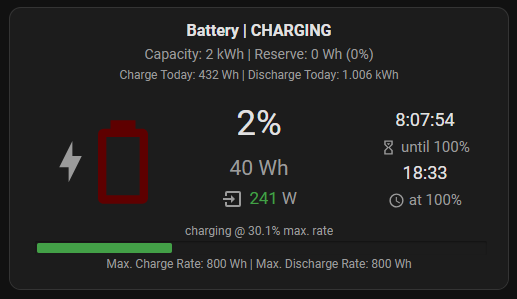

I have this working for a Foxess battery with a h3 smart inverter. I’m no expert, but figured I would share encase anyone is looking for this and wants to try get it working with a fox inverter.
I had to create a custom sensor, that used the SOC % and and the Max SOC to give the sensor for the remaining KWH,

This is the actual card (note the name, I just threw anything in there)
type: custom:givtcp-battery-card
entity: sensor.foxessinvertermb_master_version
soc_threshold_very_high: 80
soc_threshold_high: 60
soc_threshold_medium: 40
soc_threshold_low: 20
soc_colour_input: rgb_picker
soc_threshold_very_high_colour:
  - 0
  - 69
  - 23
soc_threshold_high_colour:
  - 67
  - 160
  - 71
soc_threshold_medium_colour:
  - 255
  - 166
  - 0
soc_threshold_low_colour:
  - 219
  - 68
  - 55
soc_threshold_very_low_colour:
  - 94
  - 0
  - 0
display_abs_power: false
display_type: 3
display_dp: 3
icon_status_idle: mdi:sleep
icon_status_charging: mdi:lightning-bolt
icon_status_discharging: mdi:home-battery
display_battery_rates: true
use_custom_dod: true
custom_dod: 90
calculate_reserve_from_dod: true
display_custom_dod_stats: true
display_energy_today: true
trickle_charge_filter: false
trickle_charge_filter_threshold: 25
use_custom_sensors: true
custom_soc: sensor.foxessinvertermb_battery_soc_1
custom_battery_power: sensor.foxessinvertermb_invbatpower_1
custom_soc_kwh: sensor.battery_energy_available
custom_discharge_power: sensor.foxessinvertermb_battery_discharge_1
custom_charge_power: sensor.foxessinvertermb_battery_charge_1
custom_battery_capacity_kwh: sensor.foxessinvertermb_bms_kwh_remaining_1
custom_battery_charge_energy_today_kwh: sensor.foxessinvertermb_battery_charge_today
custom_battery_discharge_energy_today_kwh: sensor.foxessinvertermb_battery_discharge_today
custom_battery_power_reserve: number.foxessinvertermb_min_soc_on_grid
custom_battery_charge_rate: number.foxessinvertermb_force_discharge_power
custom_battery_discharge_rate: number.foxessinvertermb_force_discharge_power
