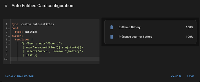

I also tried with a working template which give me all entities with a battery from a specified floor:
{{ floor_areas("floor_1")
| map('area_entities')| sum(start=[])
| select('match', 'sensor.*_battery')
| list }}
However if I try to integrate it, I get no data. I tried with:
filter:
  include:
    - name: entity_id
        value: |-
           | list }}
and with the template input:
filter:
  template: |
    {% floor_areas("floor_1") %}
    {% map('area_entities') | sum(start=[])  %}
    {% select('match', 'sensor.*_battery')  %}
    {% list %}
With different syntax:
filter:
  template: |
    value: |-
         | list }}
and:
filter:
  template: "{{ floor_areas('floor_1') | map('area_entities') | sum(start=[]) | select('match', 'sensor.*_battery') | list }}"
What am I missing?
What is expected by the “filter: include” ?
A list of entity ?
I tested those in the template tool:
I have the auto-entities card working, but I am missing the nice presentation of this card.
EDIT:
Sorry for the late spamming.
I finally got it working using the auto-entities !!
type: custom:auto-entities
card:
  type: custom:battery-state-card
  title: Battery warning
  secondary_info: "{last_changed}"
  sort:
    by: state
  collapse: 5
  bulk_rename:
    - from: " Battery"
    - from: " level"
  colors:
    steps:
      - "#ff0000"
      - "#ffff00"
      - "#00ff00"
    gradient: true
filter:
  template: |
       | list }}
Which gives me:

The last script provided above works as intended. (it displays all entities from “floor_1” in this example).
Right, I see: The auto entities card (as an alternative) indeed supports templates.

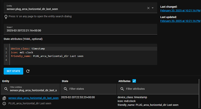

I’m trying to filter entities with *last_seen in their entity_id and state unavailable using battery-state-card, but it’s still showing many entities with the unavailable state. Here’s my YAML:
title: ZigBee Offline
icon: mdi:wifi-off
filter:
  include:
    - name: entity_id
      value: "*last_seen"
    - name: state
      value: "unavailable"
collapse: 4
bulk_rename:
  - from: Last seen
Any ideas on why this isn’t working?
Thanks!
If you want to remove the entities from the list you need to use exclude filter instead (not include one)
How can I exclude entities whose state is a timestamp?
My only goal is to see on the card when these entities have the state “unavailable”
