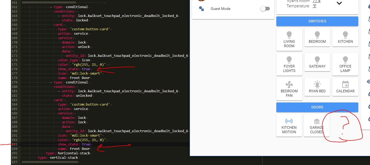

Ah. You are correct on both accounts. Quotes don’t matter and default_color is quoted in an example though not listed under the options.
To reply again, the two things that stand out to me are:
  1. Your use of “default_color:” in the locked condition card. You didn’t specify a color and it looks like default_color should only be decleared when you’re using different state colors or when color is set to auto. As your color_type is set to icon, you haven’t defined a color for the icon. In which case it may be reverting back to your theme’s primary-text-color and making it seem as if it’s not displaying. try declaring a “color:” option and see what that does.
  2. On the unlocked card, you also don’t declare a color anywhere on the card, so it could be the same issue. Again, try declaring a “color:” option and see what that does.
It’s not color related. I declared “color” like you said. The moment I put “show_state: true”, it disappears:

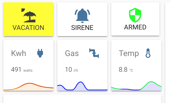

How do I get the ‘beach’ icon in the same colour as the other icons (kind a blue, but not black). This seems to be the default colour but the icon on this button card defaults to black.
  - type: 'custom:button-card'
    entity: input_boolean.vacation
    icon: 'mdi:beach'
    color: var(--primary-text-color)
    color_off: var(--disabled-text-color)
    color_type: card
    default_color: var(--primary-text-color)
    action: call-service
    service: input_boolean.toggle
    service_data:
      entity_id: input_boolean.vacation
    state:
      - color: 'rgb(255, 255, 0)'
        value: 'on'
      - color: 'rgb(255, 255, 255)'
        value: 'off'

I have not played with the size options… Might try now…
size 60 and height 90
How about this:
        style:
          - margin-left: auto
          - margin-right: auto
          - width: 50%
          - margin-top: auto
          - margin-bottom: auto
          - height: 80px
          - padding-top: 10px
Also try height: auto… not perfect on mobile…
Thanks! Works, but alot to edit.
It’s like sex, better than nothing! :grinning:
