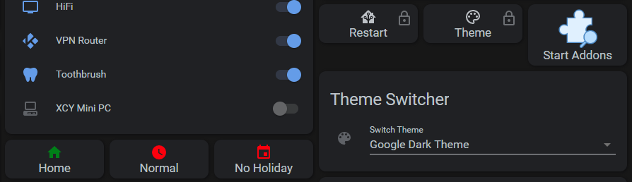

Lots of buttons have changed size in 0.110.0b0… they have a new way of doing the mdi icons now.
In my case it seems only icons using the padlock (lock function). Some icons are small but I can use CSS to resize I guess…
Tried setting aspect ratio:
So that sucks. How do I make all the icons look the same?
