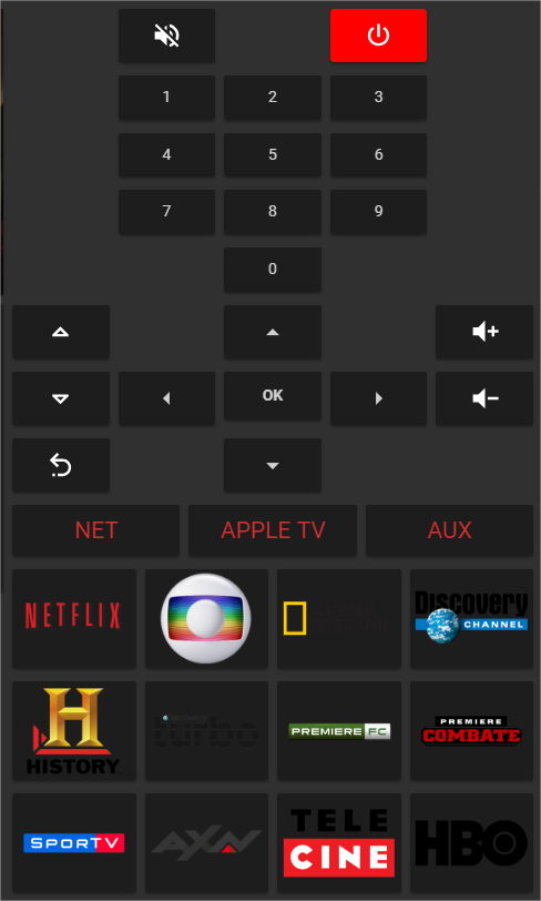

Completed work.
Button with icon, is different size of button without icon.

Good job…please share :slight_smile:
  - type: vertical-stack
    cards:
      - type: horizontal-stack
        cards:
          - type: "custom:no-card"
          - type: "custom:button-card"
            entity: script.controle_tv_sala_mudo
            icon: mdi:volume-off
            style:
              - --disabled-text-color: white
            entity: script.controle_tv_sala_power
            icon: mdi:power
            style:
              - background-color: red
        cards:
            entity: script.controle_tv_sala_1
            show_state: false
            entity: script.controle_tv_sala_2
            show_state: false
            entity: script.controle_tv_sala_3
            show_state: false
        cards:
            entity: script.controle_tv_sala_4
            show_state: false
            entity: script.controle_tv_sala_5
            show_state: false
            entity: script.controle_tv_sala_6
            show_state: false
        cards:
            entity: script.controle_tv_sala_7
            show_state: false
            entity: script.controle_tv_sala_8
            show_state: false
            entity: script.controle_tv_sala_9
            show_state: false
        cards:
            entity: script.controle_tv_sala_0
            show_state: false
        cards:
            entity: script.controle_tv_sala_cima
            icon: mdi:menu-up-outline
            style:
            entity: script.controle_tv_sala_seta_cima
            icon: mdi:menu-up
            style:
              - --disabled-text-color: var(--primary-text-color)
            entity: script.controle_tv_sala_up
            icon: mdi:volume-plus
            style:
        cards:
            entity: script.controle_tv_sala_baixo
            icon: mdi:menu-down-outline
            style:
            entity: script.controle_tv_sala_seta_esquerda
            icon: mdi:menu-left
            style:
            entity: script.controle_tv_sala_ok
            #icon: mdi:solid
            show_state: false
            style:
              - font-weight: bold
              - height: 3.1em;
            entity: script.controle_tv_sala_seta_direita
            icon: mdi:menu-right
            style:
            entity: script.controle_tv_sala_down
            icon: mdi:volume-minus
            style:
        cards:
            entity: script.controle_tv_sala_return
            icon: mdi:undo-variant
            style:
            entity: script.controle_tv_sala_seta_baixo
            icon: mdi:menu-down
            style:
              - --disabled-text-color: --disabled-text-color
              - background-color: var(--paper-card-background-color)
        cards:
          - type: picture-elements
            image: /local/img/lovelace/button-label.png
            elements:
              - type: service-button
                title: "NET"
                service: media_player.select_source
                service_data:
                  entity_id: media_player.tv_sala
                  source: "HDMI 4"
                style:
                  left: 52%
                  top: 50%
                  font-size: 1.5em
            elements:
                title: "Apple TV"
                service_data:
                  source: "HDMI 3"
                style:
                  left: 52%
                  top: 50%
                  font-size: 1.5em
            elements:
                title: "AUX"
                service_data:
                  source: "HDMI 2"
                style:
                  left: 52%
                  top: 50%
                  font-size: 1.5em
        cards:
            image: /local/img/lovelace/button.png
            elements:
              - type: image
                image: "/local/img/canais/netflix.png"
                service: script.controle_tv_sala_netflix
                tap_action: call-service
                style:
                  left: 50%
                  top: 50%
                  icon-size: 50px
                  width: 90%
            elements:
              - type: image
                image: "/local/img/canais/globo2.png"
                service: script.tv_sala_globo
                style:
                  left: 50%
                  top: 50%
                  width: 90%
            elements:
              - type: image
                image: "/local/img/canais/natgeo.png"
                service: script.tv_sala_natgeo
                style:
                  left: 50%
                  top: 50%
                  width: 90%
            elements:
              - type: image
                image: "/local/img/canais/discovery.png"
                service: script.tv_sala_discovery
                style:
                  left: 50%
                  top: 50%
                  width: 90%
        cards:
            elements:
              - type: image
                image: "/local/img/canais/history.png"
                service: script.tv_sala_history
                style:
                  left: 50%
                  top: 50%
                  width: 90%
            elements:
              - type: image
                image: "/local/img/canais/discovery_turbo.png"
                service: script.tv_sala_discovery_turbo
                style:
                  left: 50%
                  top: 50%
                  icon-size: 50px
                  width: 90%
            elements:
              - type: image
                image: "/local/img/canais/pfc.png"
                service: script.tv_sala_pfc
                style:
                  left: 50%
                  top: 50%
                  width: 90%
            elements:
              - type: image
                image: "/local/img/canais/combate.png"
                service: script.tv_sala_combate
                style:
                  left: 50%
                  top: 50%
                  width: 90%
        cards:
            elements:
              - type: image
                image: "/local/img/canais/sportv.png"
                service: script.tv_sala_sportv
                style:
                  left: 50%
                  top: 50%
                  width: 90%
            elements:
              - type: image
                image: "/local/img/canais/axn.png"
                service: script.tv_sala_axn
                style:
                  left: 50%
                  top: 50%
                  icon-size: 50px
                  width: 90%
            elements:
              - type: image
                image: "/local/img/canais/telecine.png"
                service: script.tv_sala_telecine
                style:
                  left: 50%
                  top: 50%
                  width: 90%
            elements:
              - type: image
                image: "/local/img/canais/hbo.png"
                service: script.tv_sala_hbo
                style:
                  left: 50%
                  top: 50%
                  width: 90%
That looks great! Where is this no-card ?
