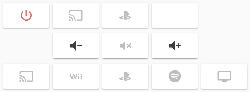

I’ve been trying this out and I’m not sure, but it seems media_player entities are not working quite right?
First of all it seems that my ChromeCast when playing looks like it is off? Since the state isn’t “ON”, but instead PLAYING it might appear as “OFF”? Just a guess.
Also my amplifier looks correct when OFF, but when ON the icon disappears? I double-checked the state and it is ON. The amplifier is supposed to appear in the top right square.
I probably need to add support for custom states eventually. For now you’re correct, it’s based on on and off
You set the color to white => color: rgb(255, 255, 255)
So when the entity is on, the color of the icon becomes white, and since your background is also white, you can’t see it. But I would bet it’s there.
Thank you … d’oh.
