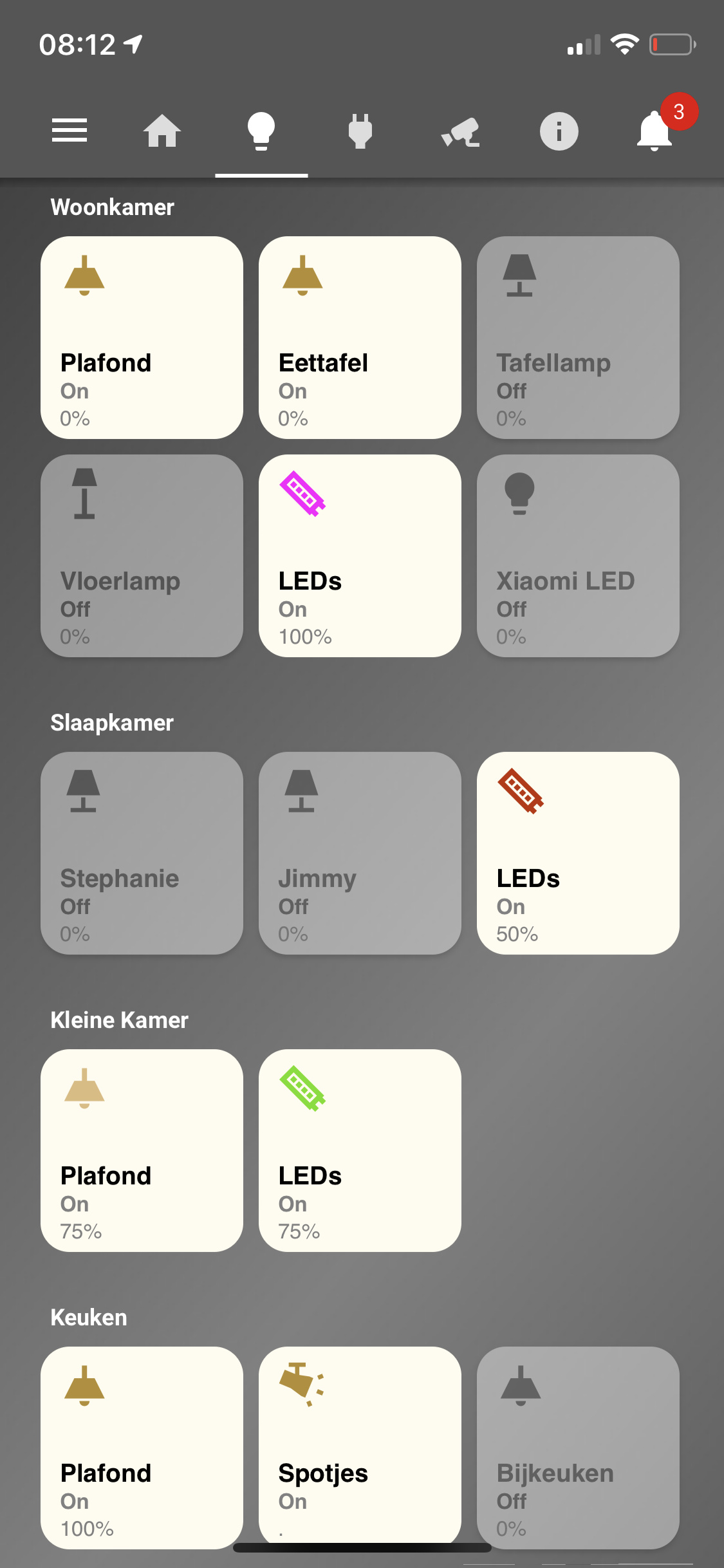

This card is truly amazing @RomRider, I actually got it to look almost like the Homekit button. The sizes are the same, text and icon placements are roughly the same. The only thing I still need to figure out is color. But here is what it looks like for now, thanks again.
Edit: And this is what it would look like if more buttons are on a page

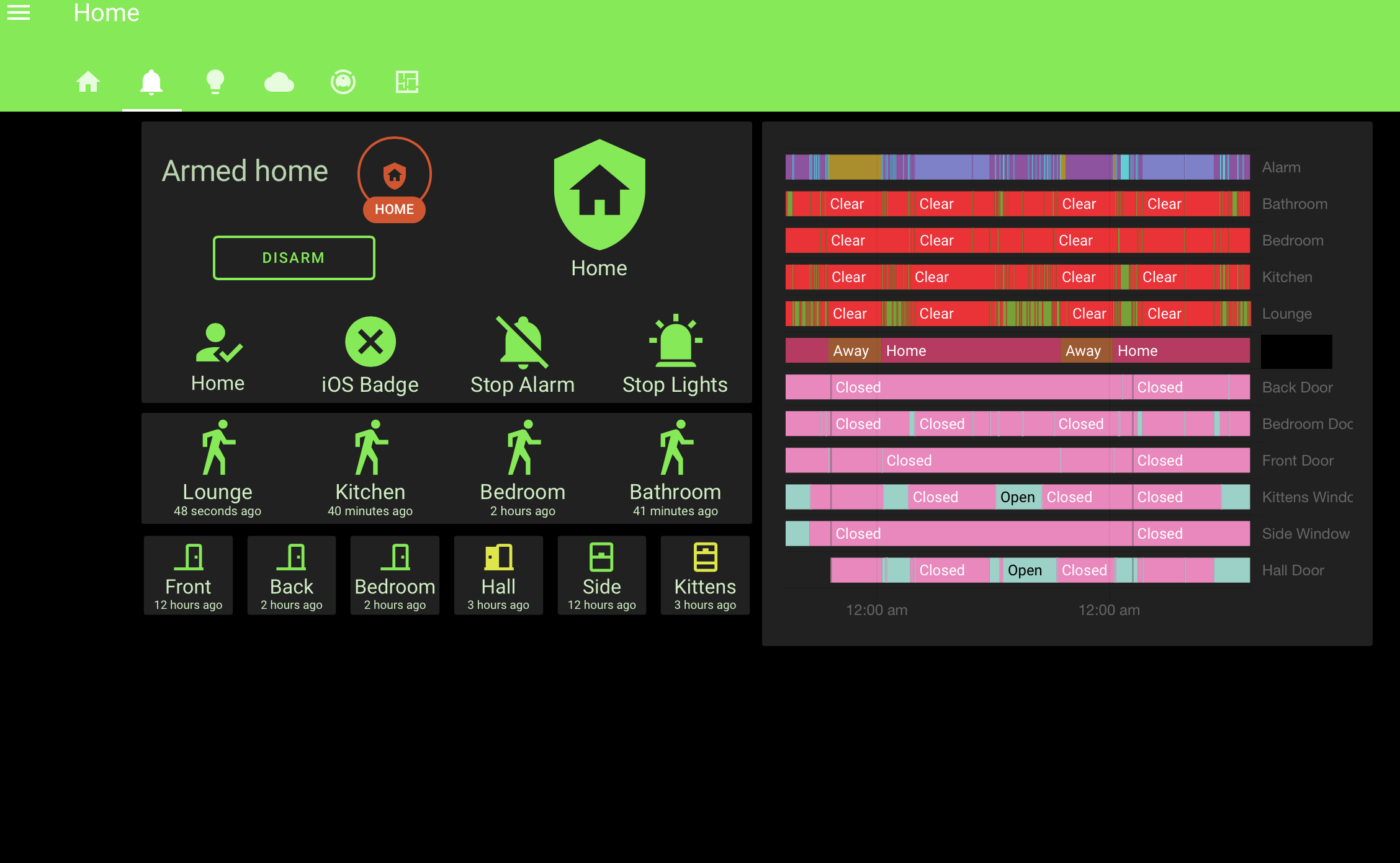

Got to say, I love this button card. I now only have a few buttons in my HA views that aren’t made from this card. It’s so versatile in allowing you to configure buttons to look and act exactly as you want.

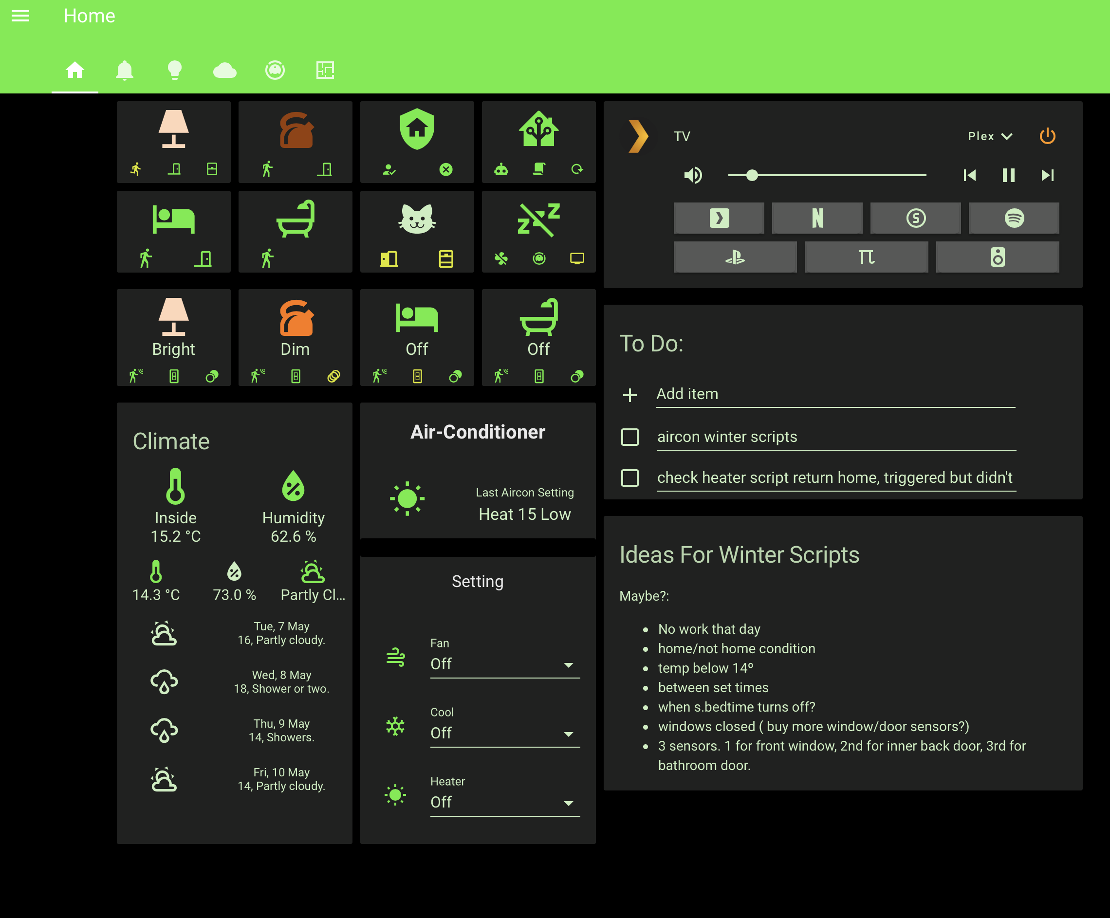

My main view is set up so that even on the ios app, I can tell at a glance exactly what’s going on in my home. And also has TV and Aircon controls, along with my notes to remind me of things to check or change. The Alarm view to give me a more detailed idea of when windows/doors opened, view the history certain entities, and lets me turn off the alarm when it’s triggered. And then light view lets me easily alter the light temps/brighness to what ever I want. My vacuum, floorplan and weather views still need work, but I’m pretty happy so far.
That looks awesome, I too am playing with this card now and one of the great things I can do now is have a gap between the borders of the screen and the first and last card (which takes away the ugly looking buttons that were on the side). This way I can make it so that it would behave more like a native ios app.

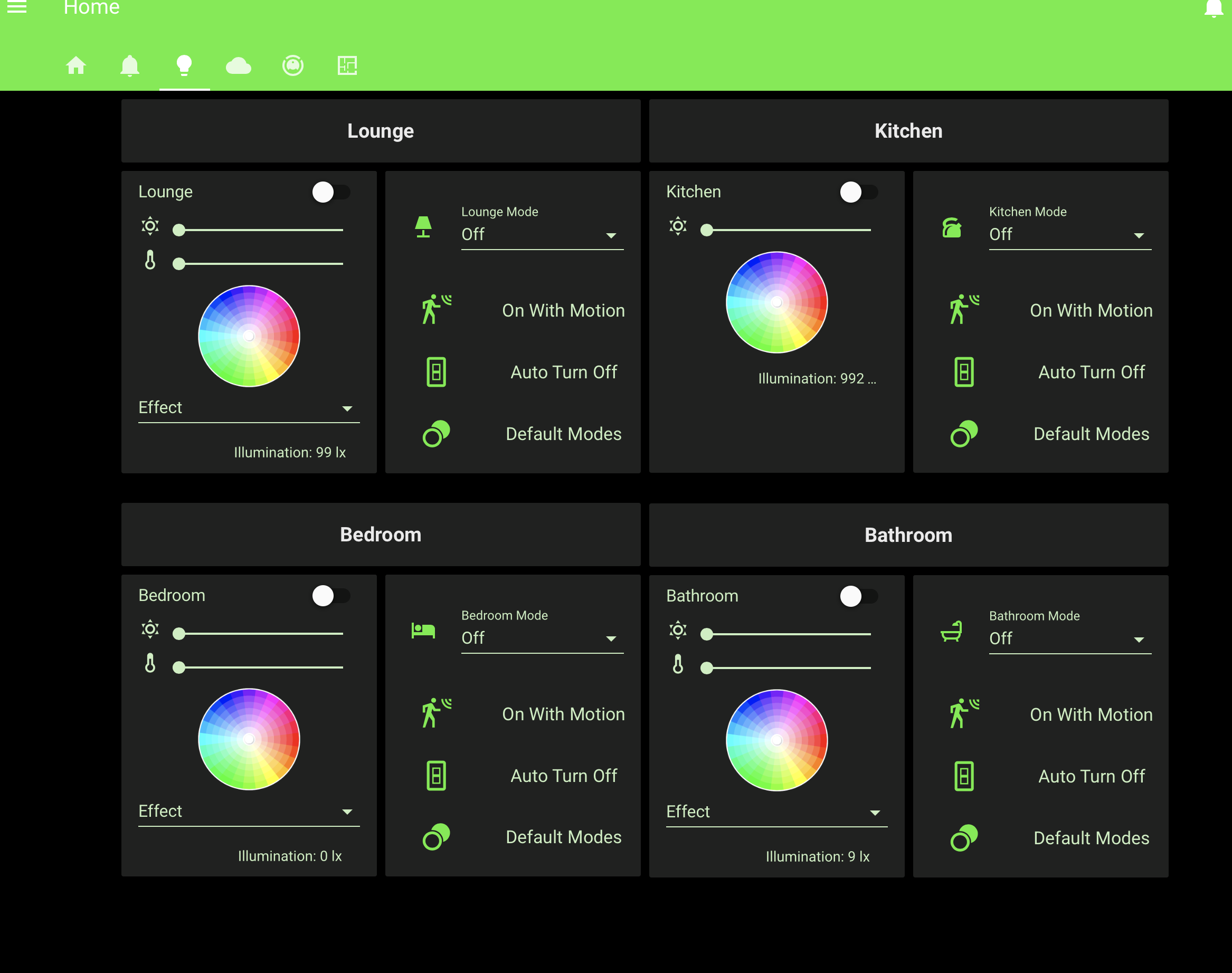

I like the color picker/brightness slider card you use, I might use that too in the future, I just wish that there was a vertical brightness slider, that would be much more logical on a smartphone.

The color picker/brightness slider is the Light Entity Card. It’s great because you can choose to have them condensed down like mine or left large. And yes, I love being able to put gaps of set sizes/colours between cards. You can’t tell on those pics, but there’s a blank-card at the bottom of each one, so that there’s a space shown on the ios app.

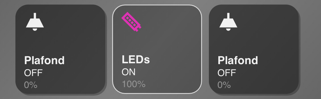

this is what I came up with.
After some more playing around I think it is getting very very close to a Homekit button
Once again great card @RomRider

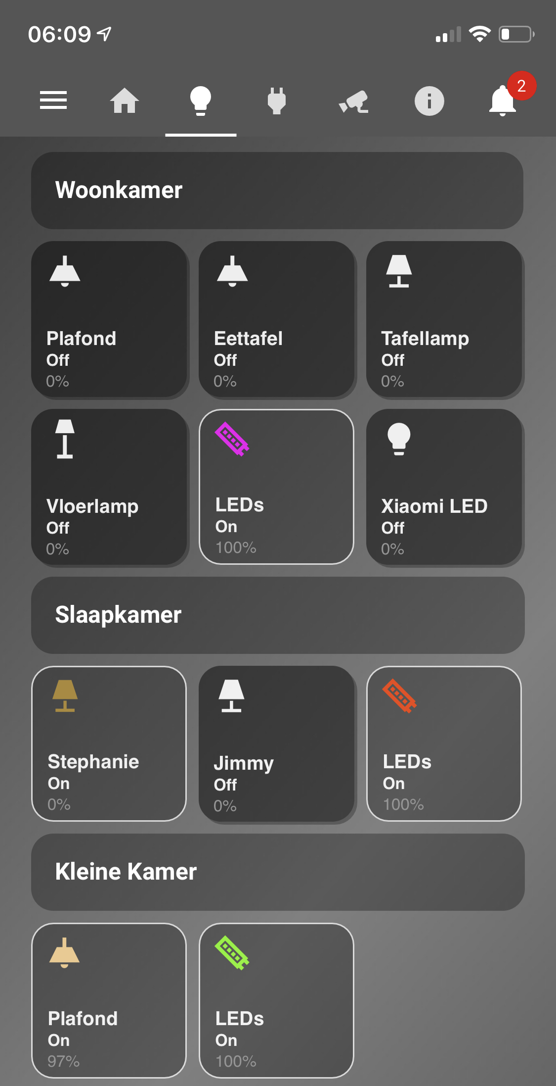

Edit: And here my latest take on the Apple Homekit button card
(This is not FINAL)
Looks great. How do you get the multiple icons at the bottom of the buttons?
I used the Vertical-stack-in-card to nest them underneath. The entire thing from the 1st Lamp card down to the end of the aircon settings are nested within a vertical-stack, with horizontal-stack and vertical-stack-in-card cards throughout. It’s 1191 lines long.
