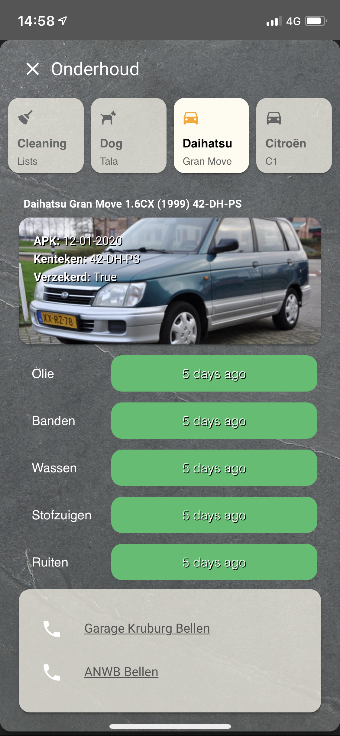

Vertical stack in card with 2 buttons inside is how I’d do it, and vertical stack in card should work with CSS, unless there’s a bug? Can you share a screenshot and a config of something which breaks the display?
The black square backgroundstay there, whatever I do, I have to mention that I use it on a popup card. I tried putting card modder on like everything, on the stacks on the cards, on everything all together, whatever I do it just won’t get transparent.
I switched to a standard vertical stack for the moment until I figure it out. Also the photo has a vertical-stack-in-card and as you can see there are black corners on the photo. Yes I have used overflow: hidden.
This is what it should look like give or take.
I’ll have a look at the code of vertical-stack-in-card, can you share your config also please, just one line is enough

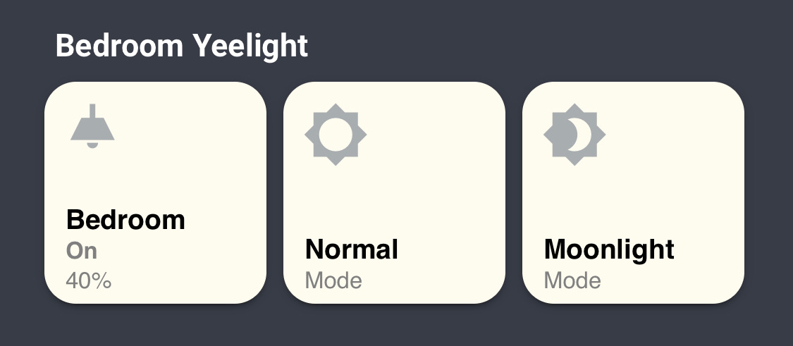

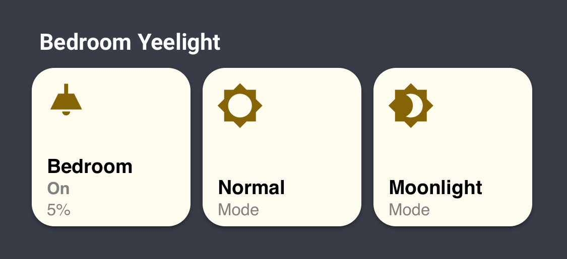

Hi @jimz011,
First off all, thank you very much for your HomeKit button! I have used it totally in my first experience with this Button card, for lights switches view and it looks just great.
Now I have one small issue with Yeelight icon coloring. The “auto” does not really always works. When I am at 5% brightness (Moonlight Mode), the color is actually fine, but when it is 40% (Normal Mode), the icon color become the same as in OFF state.
The colors actually works just fine when using the very simple glance card.
Here is Normal Mode 40% (the problematic one):
Here is Moonlight Mode 5%:
Here is how it looks with simple Glance card, both 40% and 5%, respectively:
Any idea, what might be the reason?
Thanks in advance.
Unfortunately I did not create this card, I only created a design with this card. But could you post your config it would help us find out what exactly is wrong.
