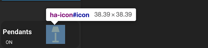

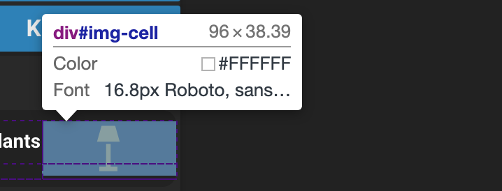

Here are some screenshots of the objects you requested. Interestingly, when I hovered over the icon, it highlighted a small area around the icon. Yet, if I hovered over the empty area between the icon and the text elements to the left, it highlighted a larger area. It’s almost as if there is another element behind the icon.
Here’s the button config

So it’s your grid columns.
try this:
- grid-template-columns: auto 55px
If you want it super close try
- grid-template-columns: auto 40px

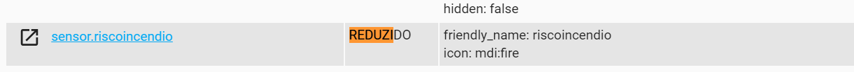

you were right. now works…but does not work for the other sensor

gotta figure out what the actual states are for the sensor.riscoincendio, remember these things are case sensitive.

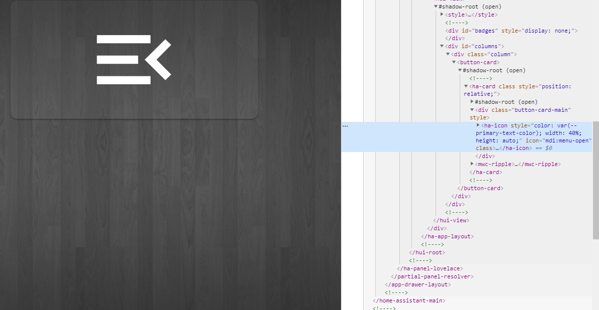

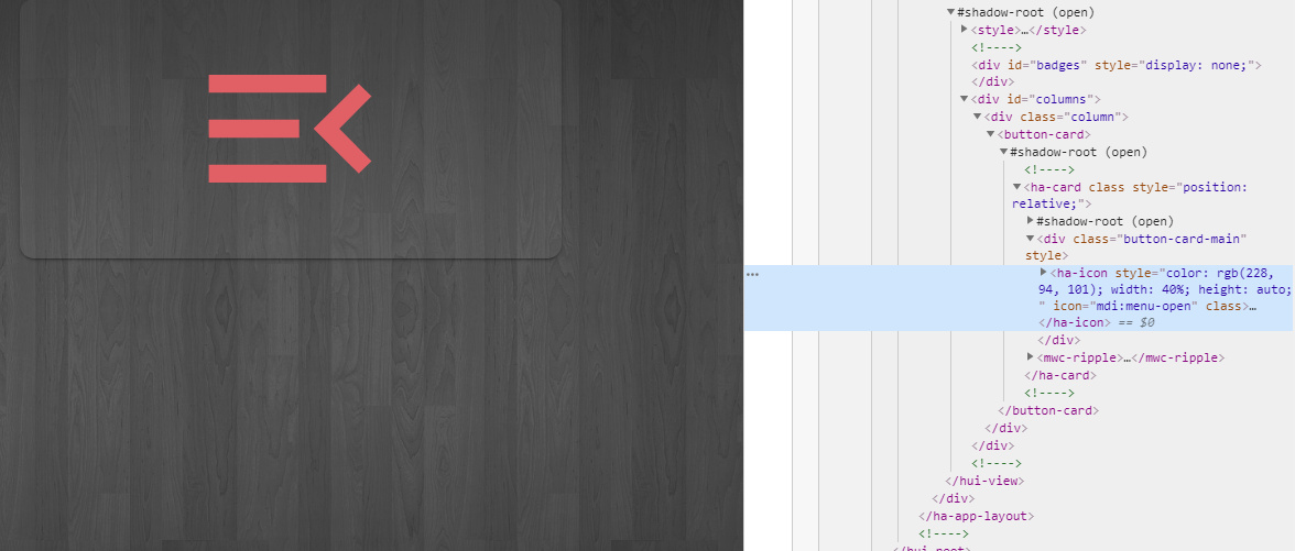

I need some help please. I cant get any of the styles to work with this card (v1.9.0) For example
- title: Test
cards:
- type: 'custom:button-card'
tap_action:
service: media_player.kodi_call_method
action: call-service
service_data:
method: Input.ContextMenu
entity_id: media_player.kodi
styles:
icon:
color: rgb(228, 94, 101)
icon: 'mdi:menu-open'
I would expect the icon to change color but it does not. If I use
- title: Test
cards:
tap_action:
service_data:
It works as expected.

Thank you, @petro. Now I understand how to manipulate that specific area of the grid. It’s interesting to see how the reduction of the px value affects the size on the X axis and makes the overall icon size smaller. I’m going to have to play around with the values to find a way to reduce the overall area being occupied without affecting the size of the icon so drastically.

The thing is no styles are being applied. I’ve tried this in firefox and chrome

then something is wrong with your install or you are using an old version
Thanks, double checked everything and you were right. It was an install error
