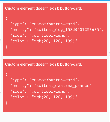

Hi all
I’m getting this error as some others I saw in this topic.
This is my config
  - url: /local/custom-lovelace/button-card/button-card.js
    type: js
  - type: vertical-stack
      - type: "custom:button-card"
        entity: switch.plug_158d0001259685
        icon: mdi:floor-lamp
        color: rgb(28, 128, 199)
        entity: switch.piantana_pranzo
Any advice?
PS: I found the issue.
In the resources part I had
    type: js
instead of
    type: module
