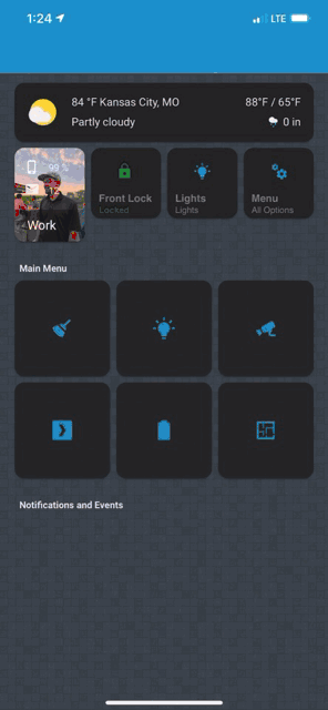

Haha I have to say that was a strange change. I do have another issue but not sure if it’s the button card. When I press a button quickly sometimes it will trigger another button that appears in the same spot. It’s like there is a second press happening. Here is a gif that shows it activating the weather pop up after pressing the back button.
That is disgusting…
Edit: With this hack, does it make it so mouse support on iOS 13 doesn’t work? I would think so.
Sounds like you are running ios 13
Edit: but no I have this too, but I think it is related to ios 13. If it isn’t I’d be happy to know.
