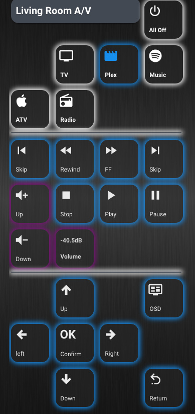

Going to give that a shot now. Not sure why I didn’t try that earlier to be fair. :slight_smile:
Thanks heaps.
Also instead of setting width and height in the card style, use aspect_ratio: 1/1, it should work better for multiple screen size and will use the whole width of you horizontal-stack automatically :wink:
Will try that after I convert the buttons over to the template. Then I can just change it on 4 lines rather than 80+. :smile: Thanks again.
Finished converting that dashboard to button_templates. Went from 1233 lines down to 187. That’s awesome!! :partying_face:
And just changed to aspect_ratio: 1/1 for the buttons and all looking good.
Will see what my wife’s response is to the revised look when she gets home. :smiley:
[edit: wife didn’t seem fussed either way so that’s a win!]
Although, to be fair, 1/1 aspect ratio isn’t actually 1/1 in my config for some reason but it’s using the space better so I don’t actually mind.
Either way, I have now taken my main remote and updated that with the templates and gone from a nightmare of 2500 lines of YAML down to a more manageable 608 lines. Still using specific height/width for the buttons on this one as I like it to have a fixed size.Thanks again @RomRider.
And one last thing to add which is relevant to the decluttering card:
Just tried it and happy to report you can use the decluttering card in conjunction with the button_card templates from custom:button-card.
I have standard buttons for everything (now) based on templates then I use the decluttering card to further simplify the config by nesting a button_card_template within a decluttering card config for the AVR commands. If I want to change the standard button that change is now in a single place.
