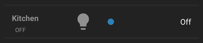

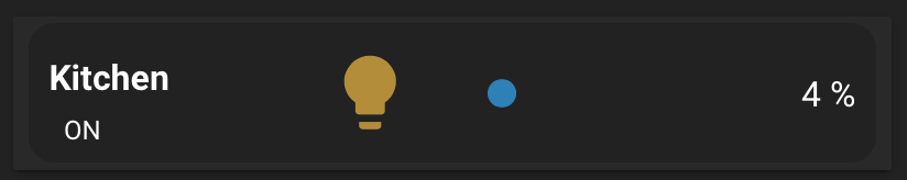

I had to sit down and really process the impact of this card before I truly understood its purpose. You, sir, are a godsend. Thank you!
Interesting behavior I’ve discovered with the new templating system. It appears that
custom:button-cards (specifically color_type: blank-card) nested inside of a horizontal-stack are not being rendered. This happens with and without the use of button-card templates. It just has to be color_type: blank-card.
Decluttered Card (Notice the missing spacing and border radius on the left and right side.)
Non-Decluttered Card
Here’s the corresponding yaml

I’ll have a look but I don’t understand the purpose of the horizontal divider? By default there is a margin of 4px between cards.
Also I don’t understand how you managed to have the initial render with this config, as the border radius are those from the vertical-stack-in-card but they display around the horizontal-stack embedded inside (that is unexpected), excluding the “spacers” on the left and on the right.
I think it just needs some refactoring :blush:
EDIT: does the layout change if you use the refresh button from lovelace (top right)?
I should probably clarify that I am encompassing my buttons inside of a vertical-stack-in-card in order to control the spacing between cards. This is how I achieved the effect of two buttons looking like one button. Of course, using vertical-stack-in-card also means that I have to explicitly create my own gaps, hence the horizontal and vertical dividers using the blank-card feature of custom:button-card.
EDIT: No, the built in refresh button has no effect. Neither does clearing the cache.
Okay I see, that adds some complexity. I had issues with vertical-stack-in-card embedded in vertical-stack-in-card.
I’ll have a look ASAP with what you provided.

My standard cards look like this:
But when I recreate them with the decluttering card I get this: (bottom row is standard config, top is decluttering-card)
Config for the buttons:
