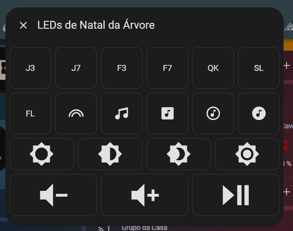

Just to let you know, and although I don’t have an explanation, if I replace all normal button cards with custom:button-card it works:
No. This is not good. You need to find out with a standard component. Probably the error is still there.
You are right, it surelly is somewhere, but in fact, all my other popup cards, with complex remotes, are done using custom:button-card, that was the only difference that I spotted. Trying to simplify led me to this… If I manage to find the error I will report back.
