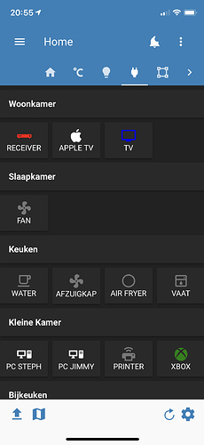

I have rows of four (see screens below) and the buttons look nice but I need to have four buttons each row or else the buttons become massive as they stretch to fit the card. Is it possible to have an empty button? Or is this only possible with the custom card which is available as well? At the moment I use a very small icon with invisible text to make the button appear like in the screenshot. I configured the button to take no action when pressed and when held.
Question 2
I have some media players in an entity-button card, just because this will turn the devices on or off. However if I use a media-player as entity-button then there is no state change on the cards (see screens below). In the screenshot my xbox and my samsung TV are both turned off, however in reality they are turned on (and the state is turned to âonâ in home assistant as well. This only applies to media-players as an entity-button. Is there any way to manually add a state color to an entity-button regardless of what the actual state is? For example: I used OpenHAB in the past, where it was possible to assign a state from a different device to a button (e.g. I could use any pingable IP to set the state of an empty button). Would this be possible here as well? Or is is possible to just have the color change?

I have found my solution in using a custom card known as: âbutton-cardâ. This card allows me to do all that I want like setting it to color the entire button instead of just the icon and put in custom state colors. For example you could give a color to your buttons depending on the state the entity is in. E.g. you could make your media player button change color depending on whether it was playing, paused or turned off.
It looks quite nice and the empty button cards are really empty (no entity or icon required). Only thing is, you canât set up a hold action which is too bad. Also to that I have made my solution with a mix of entity buttons (so I can still use the hold button function) and entity buttons for my mediaplayers and blank spaces. Obviously this mix wonât work well if you color the buttons as you canât color entity-button. See screenshots below.
As you can see my devices are colored now. My xbox for example has the state âunknownâ whenever it is just idle, so home assistant wonât see this as turned on. With this custom card I have set up a green color for my xbox whenever it is in an âunknownâ or âonâ state.
