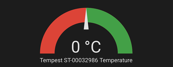

Is it possible to make a gauge with the center in the middle zero, like on the one below, and going negative value to the left, and positive value to the right with this card ?
If so, would someone have an example ?
Do not know solution but looking for the same …
Try this.
type: gauge
min: -40
max: 40
entity: sensor.tempest_st_00032986_temperature
severity:
  green: 0
  red: -40
needle: true
I love this card!
