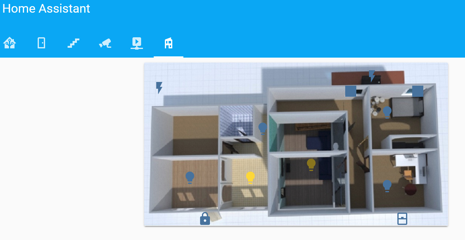

question regarding the picture elements card. is there a limit on image size? Resolution? Does it resize it? Thanks
playing with it

Is there a way to combine filters or conditions with picture element? I want a page with a background that shows things that are on, open, home etc.
Or maybe make the cards transparent and the image can be a background?
Thanks
