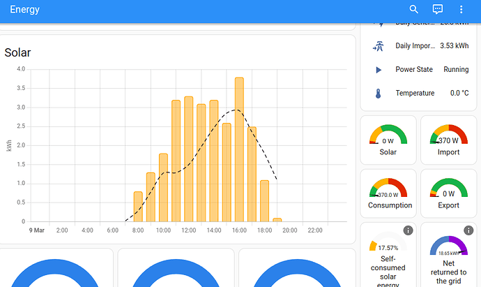

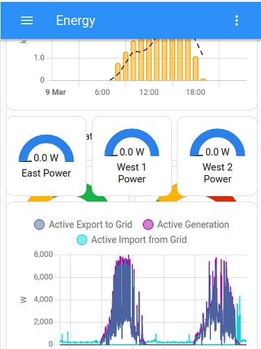

I have an issue when using the frontend integration lovelace-layout-card in grid-layout the sidebar items are appearing behind others when in the view for smaller screens:
In a normal size screen this is ok:
Does anyone know how to force the sidebar grid items to start after the main items in the mediaquery narrow view?
My layout is below:
