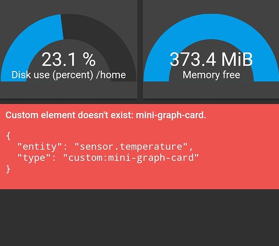

Hi. I have installed Hass.io. Before I had it installed without Hass and it worked perfectly. Now I can not tell in this environment because he can not find the card. It is located at www. What can I check to see what the error is? Thank you
#386
Working! I had to wait 2 hours as you said
#387
You need to open the dev-tools in the beowser, go on the network tab and filter by mini-graph
Click on the .js file and it will tell you the path (URL) where it is trying to donwload it to.
it should be something like:
http://192.168.0.1/local/mini-graph-card.js
/local identify your www folder, it can only be /local/ or /customcards/ if you’re using the custom_updater component.
If it’s different than that, you have something wrong in the config.
If it’s local/cards/mini-graph-card.js you need to place the file in www/cards/ inside your config folder.
Hope this helps
