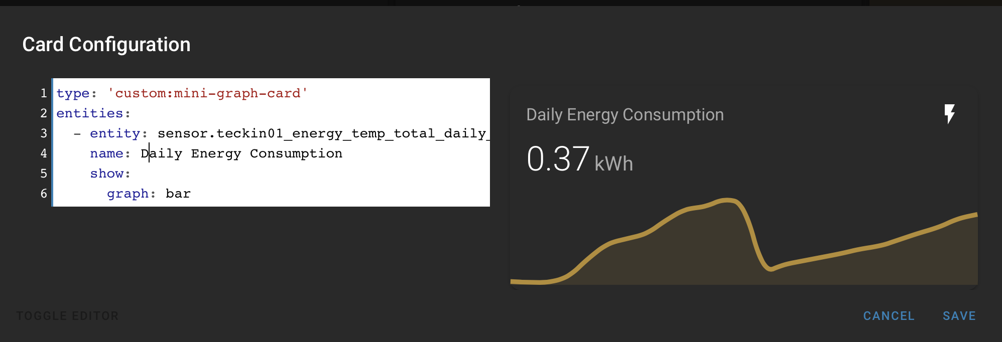

I can’t seem to get it to display a bar graph as opposed to line, can anyone shed some light on this? running latest version.
@yoni3210 what is the AC thermostat card? It looks awesome!
Your indentation is wrong, show should be on the same indentation level as type and entities.
The “show:” part is not part of entities, it needs to be at the same “level” of entities:
entities:
- entity lists
show:
show options```

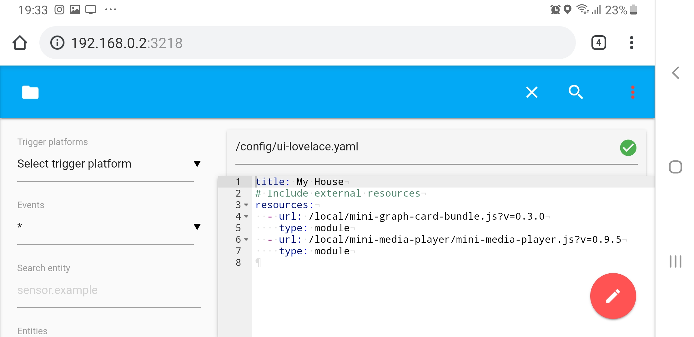

To clarify. If I am using tracker card do I still need to add the reference in the raw config editor?
Quick question regarding this instruction:
“ 1. Add a reference to mini-graph-card-bundle.js inside your ui-lovelace.yaml “
Do I have to make/use ui-lovelace.yaml or can I just add the reference to the top of the storage mode config using the raw config editor?
Yes just add resources in the raw editor…
If you are using custom_updater do this:
Replace ?v=0.3.0
With:?track=true
Change /local/
With /customcards/
If you’re not using custom_updater remove the ?v=0.3.
Let me know

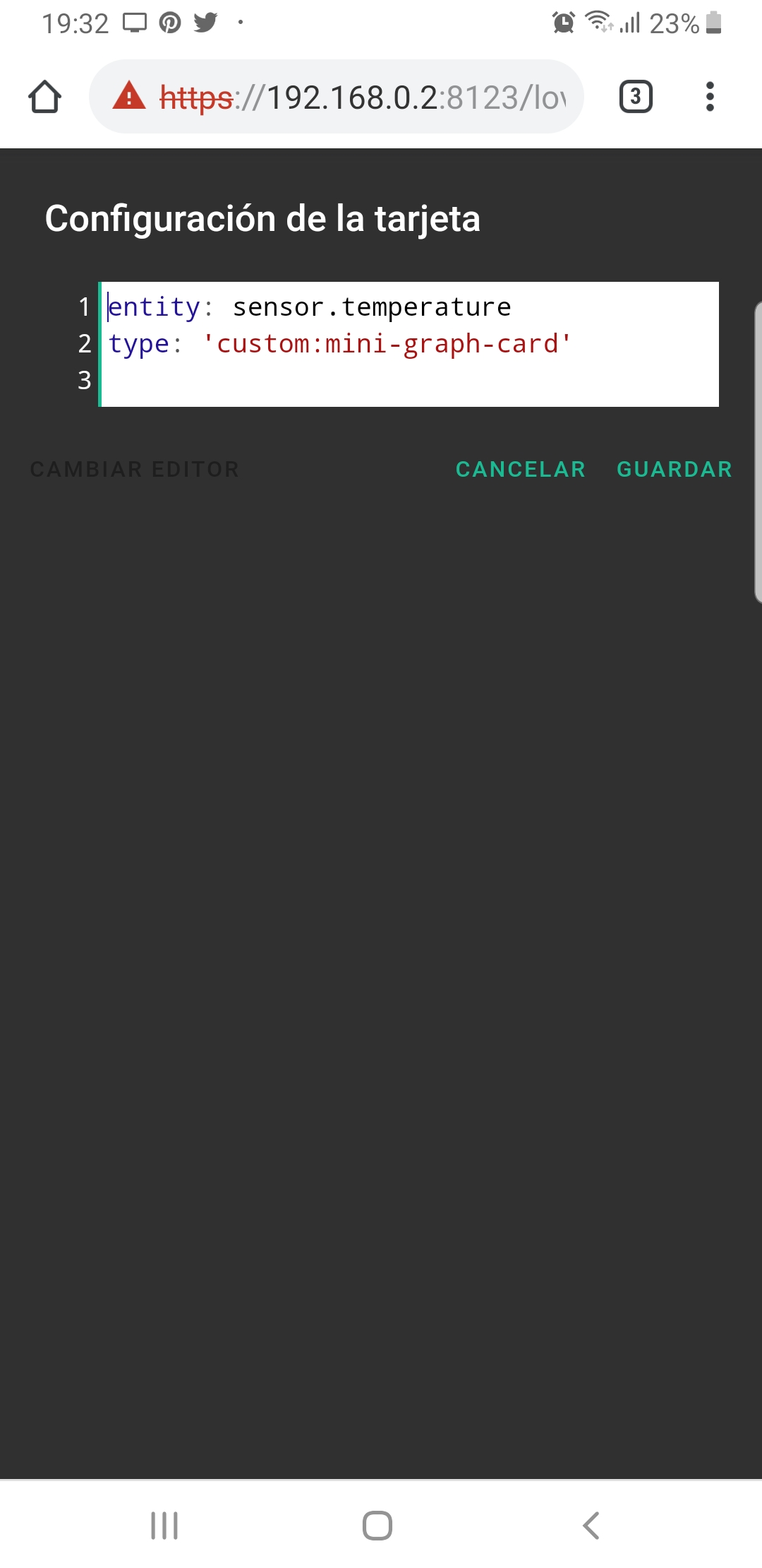

Thanks. I’m not use custom_updater. I remove ?v=0.3.0 and not work
Can you try to use this code instead?
type: custom:mini-graph-card
entities:
entity: sensor.temperature
