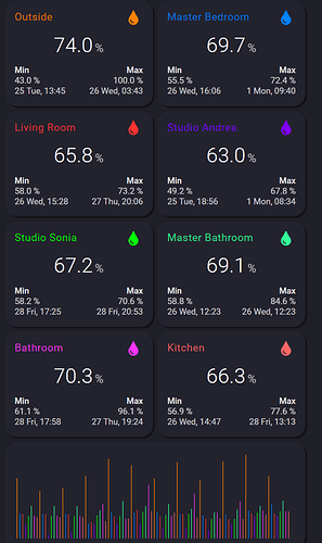

Yesterday I was thinking about something that might be a good feature.
The ability to set per-graph a min and max value that the card will use to generate the graph.
Example:
I know that the green bar is approximately 95%, while the blue one, as per text is 69.6%, but it doesn’t “look like it”.
If I was able to add min: 0 max: 100 the graph would generate those bars based on the scale between a min and a max, same would apply for temp if for instance I would set min: -5 max: 45
Would that make sense?
Would that be possible?
Cheers

Hey Andrea,
Nice to hear from you again
Nice card setups you got there!
Great idea, certainly useful, it should be possible to achieve already, try the lower_bound and/or upper_bound options and let me know if that does the trick
That’s it! Perfect!

How about been able to stack the bars on each other instead of next to each other?
This would help in the following example (multiple humidity sensors to have an overview across the house)
Of course I can switch it to lines but it doesn’t look “as good” in this scenario
Would be cool, but I think it could be hard to implement, discussed briefly here, since I’m not using any graph library, I would have to build it from the ground up.
