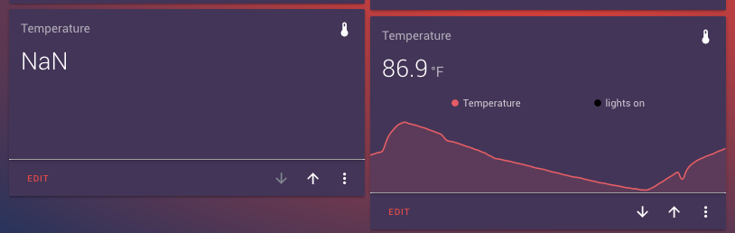

OK. So I updated my binary sensor a little bit and input that as an entity to read in the mini graph card.
As a y_axis secondary, the values are 0 and 0. In a graph by itself it reads as NaN with no graph values.
Looking at my History panel, I see no line graph data for either the binary_sensor or the sensor template I created of the binary_sensory.
Could this be why there isn’t data loading to the mini graph?
I appreciate the help in this matter. If you have a Ko-fi, paypal, or patreon, I’d love to donate.
