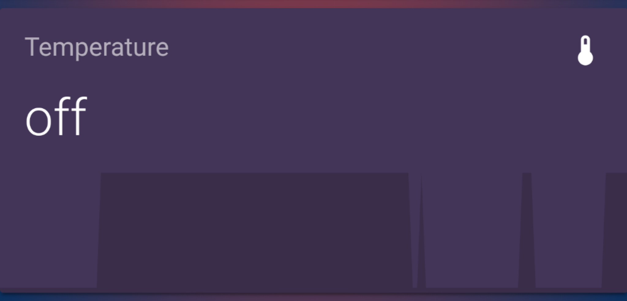

Yes! But I didn’t try it with your setup, I think I found a more straight forward solution, possible thanks to the state_map feature from the last update.
- type: custom:mini-graph-card
    - sensor.temp
    - entity: binary_sensor.night
      color: rgba(255,255,255,.25)
      y_axis: secondary
      smoothing: false # for binary_sensor smoothing is automatically turned to false by default so this line is unnecessary in this case
      aggregate_func: min
      show_state: true
      show_line: false
      show_points: false
  state_map:
    - value: "off"
      label: "Day"
    - value: "on"
      label: "Night"
hyperion_8123_lovelace_example%20(16)
And the only sensor setup you need is:
binary_sensor:
  - platform: tod
    after: sunset
    before: sunrise
Hope this will work for you!
