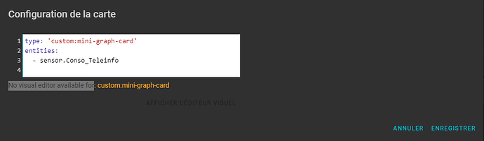

Hi all !
I have a problem with this plugin
Install with HACS, sensor is OK in the default card :
to the top of my raw config :
and mini-graph-card-bundle.js + js.gz are all two in the good folder \config\www\community\mini-graph-card
do you have any idea of what i’m doing wrong ?
Thanks in advance
Don’t use capital letters in your entity ids.
Wow, wasn’t a probleme for the default card, but was a problem for mini_graph_card …
Solved my problem,
Many Thanks !!

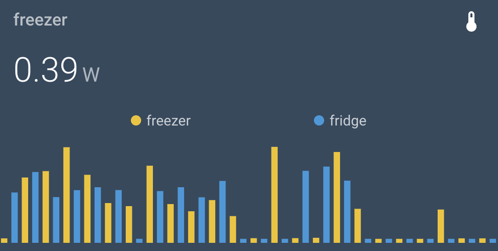

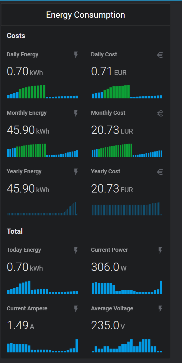

Andrea would you mind to share this lovely setup for power consumption monitoring
I would like to copy many parts of it, if you allowed me. One final question no solution yet for utilty meter monthly readings right? I have been digging in the last 500 posts,
On the other hand and totally off-topic, do you consider or have any card to show stacked bar with several entities compared with total consumption?
Hi Diego,
My whole configuration it is now available on GitHub at this address: https://github.com/SeLLeRoNe/HA-Config
For the monthly reading for now no, there is no solution.
And for the last bit, it would be very nice if the mini-graph-card would have the ability to stack on bars because that would allow me to have the total with “a bar per room” and different color to easily see what room is counsuming what, specially in the “whole house” view of things:
To be honest, I didn’t look for other cards, specially because I love this card and I prefer to wait for it to have it
Thanks a lot Andrea @SeLLeRoNe I do like a lot mini-graph-card, I have used Grafana but it is terrible slow, it just the stack bar the only function I miss from power and energy monitoring. For the rest I´m using mini-graph-card
