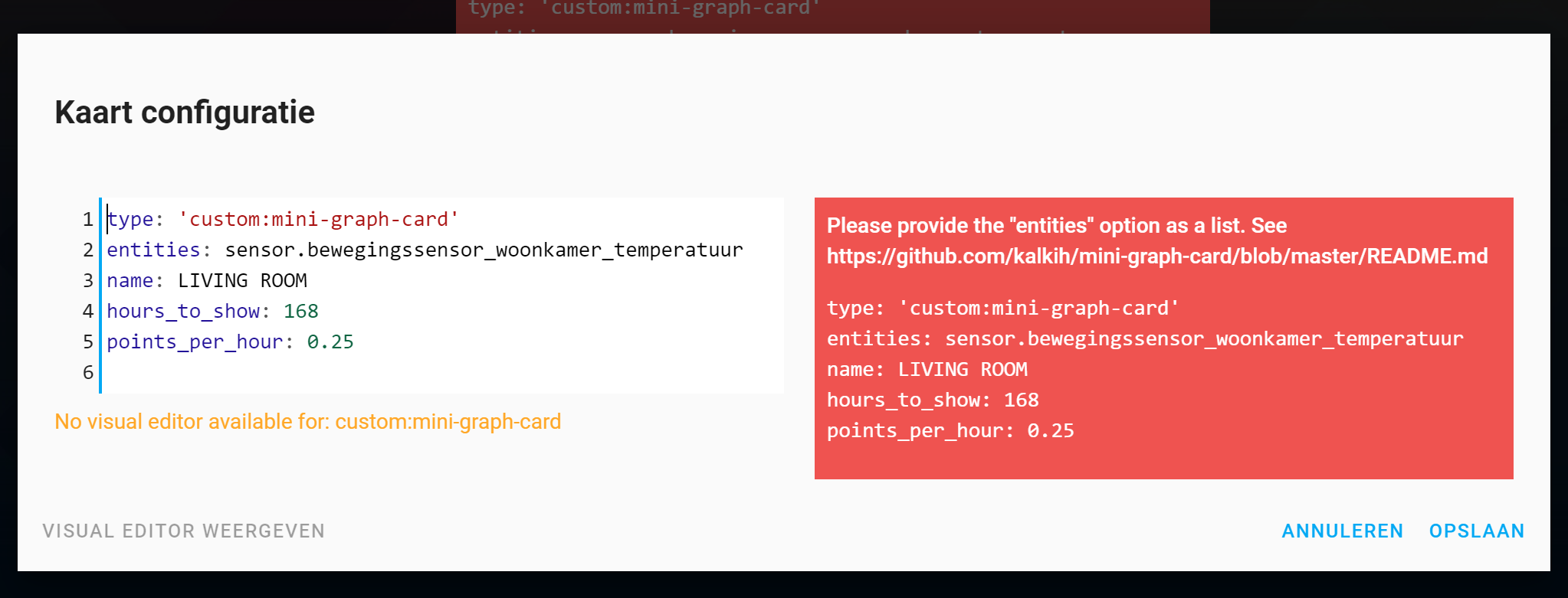

I get the following error:
Does anyone know the solution.
Thanks!!
      - type: custom:mini-graph-card
        entities:
          - entity: sensor.your_sensor_name
