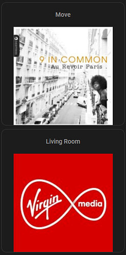

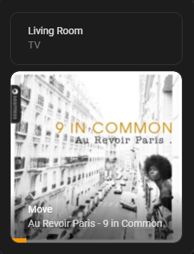

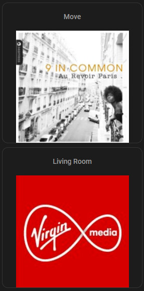

Is there a way to supply/override the artwork when none is available?
Instead of the player just being small and text only when the TV is the source
I’d like to supply an image of the device/channel that’s in use by the TV.
I’ve had a look at Card-Mod, but can’t see how I’d need to change it, as the player doesn’t have the artwork field
You can set a background. The full solution is on this topic.
Not background, Artwork. they’re different.
Sorry, I wasn’t clear.
I was answering this specifically:
