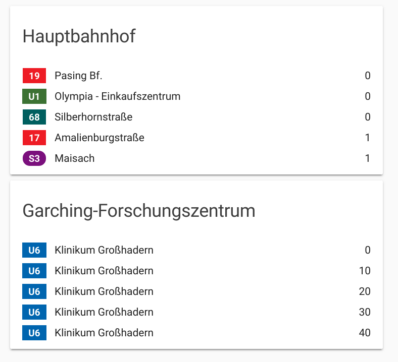

Playing around with the awesome new Lovelace UI, I created a custom card to show live departure times for public transport in Munich, using the MVG Live sensor. (To make this possible I also had to modify the sensor and will submit the modifications as a PR soon.)
Example result:

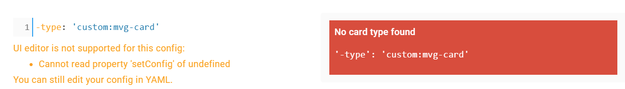

Hi could you help me out?
I put your js in config/www/custom_lovelace/mvg_card.js
Added it as a resource in Lovelace Settings as /local/mvg_card.js (and also /local/custom_lovelace/mvg_card.js because i was not sure)
And tried to add it to Lovelace with - type: 'custom:mvg-card'
But i only get:
You’re missing a space between - and t
The problem was either the double entry of the mvg-card.js in the resources or the missing entity.
With this it worked:
entity: sensor.LOCATION_NAME
No - needed at all in the card editor.

Result:
Unfortunately, there are virtually no detailed tutorials for creating custom cards. There are still a few issues in mine (e.g. working preview via setConfig()). I would be very happy if someone here could find good documentation or tutorials for this. The whole topic is only touched on very superficially on the developer pages.
Well, it works well at the moment. Maybe there is someone else here who can improve it a bit :wink:
Have fun with it and best regards from Munich!

result:
