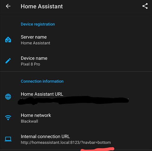

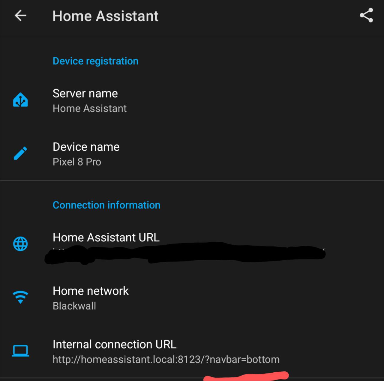

card for mobile devices is not working, error says custom element doesent exist, is there any other way to make it work on companion app?
Don’t use card and change internal and external urls in your app by adding navbar param =)
