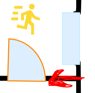

As I continue to migrate my Floorplans to Lovelace I can’t seem to figure out how to make a single binary_sensor (door) have a special color if it was the last door used.
Ideally I would like to make it just background light green, so the default blue/yellow still shows as the sensor may still trigger for it.

UPDATE: What I have figured out is that I can “some what” acheive my goal by using
1 image for the back door shape to give me the default blue/yellow.
- type: image
  entity: binary_sensor.back_gds_58
  tap_action: none
  state_image:
    "on": /local/lovelace_ui/door90_on.png
    "off": /local/lovelace_ui/door90_off.png
  state_filter:
    "off": grayscale(72%)
  style:
    left: 69%
    top: 50%
    width: 9%
A 2nd image to provide an indicator to mark the last door that had activity. This image is tied to a template where I calculate that last active door. Thus the state_filter is for the specific icon at the specific location.
- type: image
  entity: sensor.template_last_door_open
  tap_action: more-info
  image: /local/feet_dark.svg
  filter: opacity(1%)
  state_filter:
    "Back GDS": opacity(50%)
  style:
    left: 69%
    top: 50%
    width: 9%
The sucks part is I’ll have to make the same image for each door and only define its state_filter to show the image when the given door is set. Not ideal but it works.
I’m just trying to figure out how to color the svg image orange.

Try use hue-rotate and saturate to set the color on the svg file.
  - entity: binary_sensor.coolcam_door_front_sensor
    filter: hue-rotate(50deg)
    image: /local/pixcel2.svg
    state_filter:
      idle: brightness(80%) hue-rotate(360deg) saturate(100.0)
      'off': brightness(90%) hue-rotate(360deg) saturate(100.0)
      'on': brightness(70%) hue-rotate(295deg) saturate(100.0)
    style:
      left: 84%
      top: 71%
      width: 10%
    type: image
