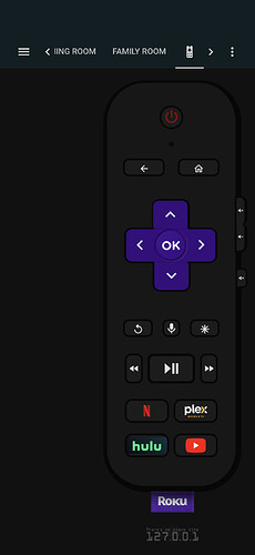

šŸ“ŗ Lovelace: Roku Remote Card
If you install it through HACS you don’t have to put that anywhere.
Thank you for this card. It works flawlessly, looks great with my taste in dark mode themes, and was easy enough for a novice like me to implement. If you wouldn’t mind giving me a hand, one thing I tried to do but failed on was changing the font color. I don’t know if the code I used was wrong or if I just put it in the wrong place. The other thing I haven’t tried yet, but want to, is using my own images for the ā€œiconsā€ for the different channels. My question is do I need to resize the images to a particular size or do they size themselves and fit on their own?
Hi, can you please advise me how you got it working. I downloaded the roku card using HACS but idk how to access it on the dashboard because I do not see any cards.
EDIT: Looks like the custom card with the text risk1994 added above works. Still can’t see this card as an actual selectable card when using +Add card. Installed via HACS too.
i had to manually create ā€˜custom card’ in dashboard for it to work. I was confused too initially. Didn’t have to do ā€˜resource’ thing. I am sure instructions can be little bit more explicit.
Almost done with my Roku card…
Okay, so last I need is away to interact with a keyboard so we can use the search function…
type: vertical-stack
  - type: custom:gap-card
    height: 4
  - cards:
      - type: custom:mod-card
        card_mod:
          style: |
            ha-card {
                margin-left: 40%;
                margin-right: 4%;
                border-radius: 70px 70px 70px 70px;
                border-top: solid 4px;
                border-right: solid 10px;
                border-bottom: solid 10px;
                border-left: solid 6px;
                #border: double 8px;
                #border: double;
                background-color: #181718;
                border-color: #070707;
        card:
              height: 30
            - type: vertical-stack
                - type: conditional
                  conditions:
                    - entity: select.g03harmonyhub01_activities
                      state: Watch Plex
                  card:
                    type: horizontal-stack
                        height: 40
                      - type: custom:button-card
                        icon: mdi:power
                        color: darkred
                        styles:
                          card:
                            - height: 40px
                            - width: 40px
                            - border-radius: 100px
                            - border: solid 3px
                            - border-color: '#070707'
                            - background-color: '#1c1c1c'
                        tap_action:
                          action: call-service
                          service: remote.turn_off
                          service_data:
                            device_id: f8b25b98a4bf4375b8cb8c23c7e15fef
                        height: 40
                - type: conditional
                  conditions:
                      state: power_off
                  card:
                        icon: mdi:power
                        color: rgba(255, 255, 255, .15)
                        styles:
                          card:
                            - height: 40px
                            - width: 40px
                            - border: solid 3px
                        tap_action:
                          service: remote.turn_on
                          hapxics: medium
                          service_data:
                            entity_id: remote.g03harmonyhub01
                            activity: watch plex
              height: 1
            - type: horizontal-stack
                  height: 20
                  styles:
                    card:
                      - height: 8px
                      - width: 8px
                      - border: solid 3px
                  height: 20
                  height: 40
                  icon: mdi:arrow-left
                  styles:
                    card:
                      - height: 30px
                      - width: 70px
                      - margin-bottom: -10
                      - margin-left: '-10%'
                      - border-radius: 10px
                      - border: solid 3px
                  tap_action:
                    hapxic: success
                    service: remote.send_command
                    service_data:
                      entity_id: remote.roku_ultra
                      command: back
                  icon: mdi:home-outline
                  styles:
                    card:
                      - height: 30px
                      - width: 70px
                      - margin-left: 10%
                      - border: solid 3px
                  tap_action:
                    hapxic: success
                    service_data:
                      command: home
                  height: 40
                  styles:
                    plho1: null
                    card:
                      - height: 34px
                      - width: 18px
                      - border: solid 0px
                      - background-color: transparent
                  icon: mdi:chevron-up
                  styles:
                    card:
                      - z-index: 1
                      - height: 50px
                      - width: 64px
                      - margin-top: 20px
                      - margin-right: 18px
                      - margin-bottom: '-10px'
                      - border-radius: 13px 13px 0px 0px
                      - border-top: solid 3px
                      - border-bottom: solid 0px
                      - border-right: solid 4px
                      - border-left: solid 2px
                      - background-color: '#360d7c'
                  tap_action:
                    service_data:
                      command: up
                    haptics: light
                  icon: mdi:volume-plus
                  styles:
                    card:
                      - height: 48px
                      - width: 21px
                      - margin-top: 15px
                      - margin-right: '-20px'
                      - border-radius: 0px 12px 10px 0px
                      - border-left: solid 3px
                      - border-right: solid 5px
                  tap_action:
                    hapxic: success
                    service_data:
                      command: volume_up
                  styles:
                    plho2: null
                    card:
                      - height: 34px
                      - width: 10px
                      - border: solid 0px
                  icon: mdi:chevron-left
                  styles:
                    card:
                      - z-index: 1
                      - height: 60px
                      - width: 50px
                      - margin-right: '-10px'
                      - border: hidden  0px
                      - border-radius: 13px 0px 0px 13px
                      - border-bottom: solid 3px
                      - border-right: solid 0px
                      - background: '#360d7c'
                      - outline: hidden
                      - box-shadow: none
                  tap_action:
                    hapxic: success
                    service_data:
                      command: left
                  show_entity_picture: true
                  entity_picture: /local/icons/remote-roku-ok2.png
                  styles:
                    card:
                      - z-index: 2
                      - height: 60px
                      - width: 60px
                      - border: solid 0px
                  tap_action:
                    hapxic: success
                    service_data:
                      command: select
                  icon: mdi:chevron-right
                  styles:
                    card:
                      - z-index: 1
                      - height: 60px
                      - width: 50px
                      - margin-right: 11px
                      - margin-left: '-10px'
                      - border-radius: 0px 13px 13px 0px
                      - border-right: solid 3px
                      - border-left: solid 0px
                  tap_action:
                    hapxic: success
                    service_data:
                      command: right
                  icon: mdi:volume-minus
                  styles:
                    card:
                      - height: 48px
                      - width: 21px
                      - margin-top: '-6px'
                      - border-radius: 0px 10px 12px 0px
                      - border-top: solid 0px
                  tap_action:
                    hapxic: success
                    service_data:
                      command: volume_down
                  styles:
                    plho3: null
                    card:
                      - height: 34px
                      - width: 20px
                      - border: solid 0px
                  icon: mdi:chevron-down
                  styles:
                    card:
                      - z-index: 0
                      - height: 50px
                      - width: 64px
                      - margin-left: '-19px'
                      - margin-top: '-10px'
                      - border-radius: 0px 0px 13px 13px
                  tap_action:
                    hapxic: success
                    service_data:
                      command: down
                  icon: mdi:volume-mute
                  styles:
                    card:
                      - height: 34px
                      - width: 20px
                      - border-radius: 0px 8px 8px 0px
                  tap_action:
                    hapxic: success
                    service_data:
                      command: volume_mute
              height: 20
                  icon: mdi:replay
                  styles:
                    card:
                      - height: 30px
                      - width: 50px
                      - margin-right: 8px
                      - border: solid 3px
                  tap_action:
                    hapxic: success
                    service_data:
                      command: replay
                  icon: mdi:microphone
                  styles:
                    card:
                      - height: 30px
                      - width: 30px
                      - border: solid 3px
                  tap_action:
                    hapxic: success
                    service_data:
                      command: play
                  icon: mdi:asterisk
                  styles:
                    card:
                      - height: 30px
                      - width: 50px
                      - margin-left: 8px
                      - border: solid 3px
                  tap_action:
                    hapxic: success
                    service_data:
                      command: info
                  icon: mdi:rewind
                  styles:
                    card:
                      - height: 50px
                      - width: 30px
                      - border: solid 3px
                  tap_action:
                    hapxic: success
                    service_data:
                      command: reverse
                  icon: mdi:play-pause
                  styles:

I’ve refactored his a bit. Here’s the outcome and code. Can probably be cleaned up some still, but it functions and looks good atm.
Do a find and replace search
Replace below with your remote entity
remote.65_tcl_roku_tv
Replace below with your media_player entity
media_player.65_tcl_roku_tv
card_mod:
  style: |
    ha-card {
        max-width: 260px;
        margin: 0 auto;
        #border: double;
card:
          styles:
            card:
              - height: 50px
              - width: 80px
              - border: solid 3px
          tap_action:
            hapxic: success
            service_data:
              entity_id: remote.65_tcl_roku_tv
              command: play
          icon: mdi:fast-forward
          styles:
            card:
              - height: 50px
              - width: 40px
              - border: solid 3px
          tap_action:
            hapxic: success
            service_data:
              command: forward
      height: 10
          entity_picture: https://i.ibb.co/2n4ptXY/netflix-button.png
          styles:
            card:
              - height: 40px
              - width: 80px
              - border: solid 3px
          tap_action:
            service: media_player.select_source
            service_data:
              entity_id: media_player.65_tcl_roku_tv
              source: Netflix
          entity_picture: https://i.ibb.co/NYRtJqm/plex-button.png
          styles:
            card:
              - height: 40px
              - width: 80px
              - border: solid 3px
          tap_action:
            service_data:
              source: Plex - Free Movies & TV
          entity_picture: https://i.ibb.co/Ph92KYM/hulu-button.png
          styles:
            card:
              - height: 40px
              - width: 80px
              - border: solid 3px
          tap_action:
            service_data:
              source: Hulu
          entity_picture: https://i.ibb.co/JQzyVSz/yttv-button.png
          styles:
            card:
              - height: 40px
              - width: 80px
              - border: solid 3px
          tap_action:
            service_data:
              source: YouTube TV
      height: 30
