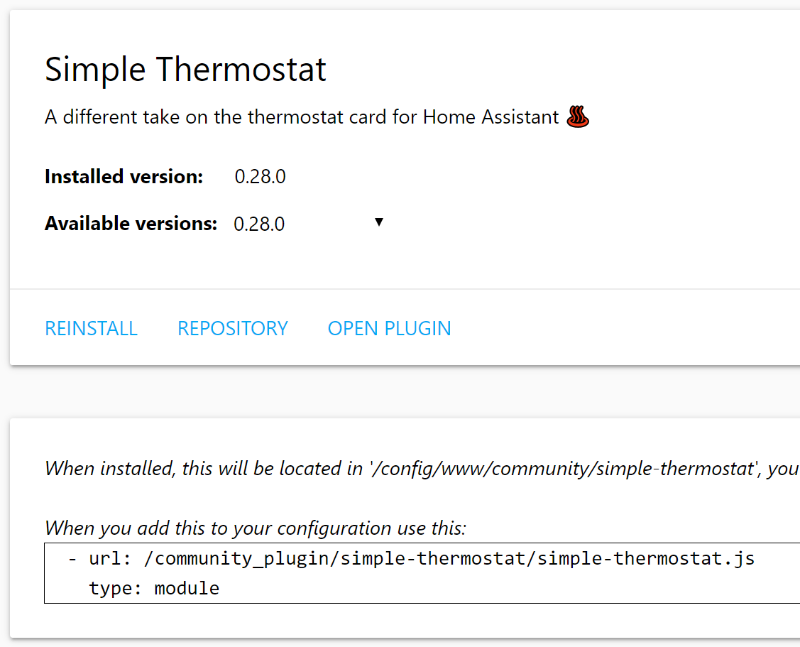

Hi all,
actually i have version 0.26.0-0 installed. If i try to upgrade to 0.28 it doesn’t work. No error but no new version. I try to uninstall then reinstall but i’m still having version 0.26.0-0 installed.
Any idea?
EDIT:
ok it’s working: upgrade to the master version and then 0.28 working!

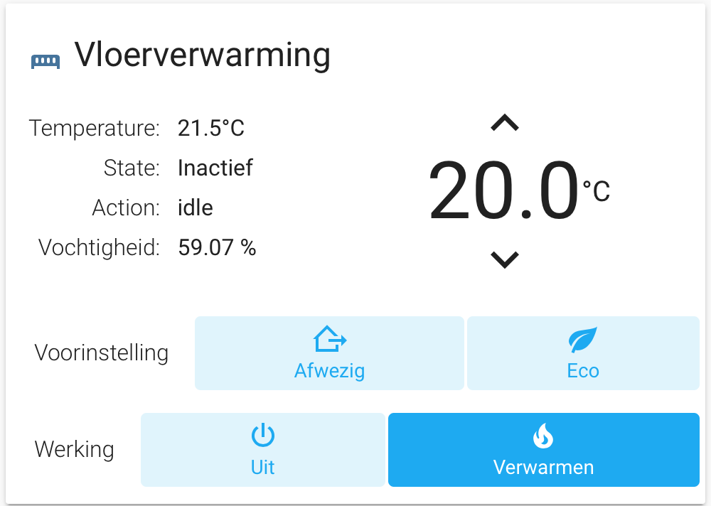

Thanks for the update! The 0.28 version is working fine with my Honeywell Round thermostat:
  - type: custom:simple-thermostat
    entity: climate.honeywell_round
    control:
      preset:
        away:
          icon: mdi:home-export-outline
        eco:
          icon: mdi:leaf
    sensors:
      - entity: climate.honeywell_round
        attribute: hvac_action
      - entity: sensor.woonkamer_multisensor_relative_humidity
